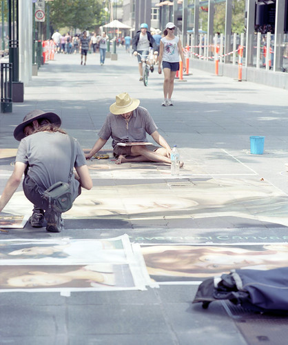

The below shot is exposed for the shade (incident metered in the shade) there is 5 stops of different in the direct sun and shade in this particular scene (via incident metering in both), I did this to get good mid tones in the shade, yet I have simultaneously good mid tones in both, though the image is of lower contrast as a consequence of this exposure. But when your subject is mixed over hard sun light and shade with a huge contrast difference, that is a benefit.
OCAU Melb Photowalk Week 2 #11 by athiril, on Flickr

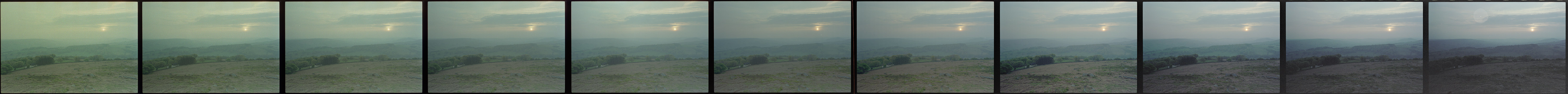

Here's a shot taken on an olympus OM1 with each exposure separated by a whole stop..
The far right exposure is -4 stops and the far left exposure is +6 stops.. Drum scanned on a Howtek 4500 with Aztek DPL..
The scene is from 16LV (ev@100) next to the sun to 7LV in the shadowed trees. Clouds are around 11LV which the exposure was taken for. foreground is about 9LV
Given that the next to the sun bit doesn't blow out and it's at +5EV already, then we get +11 EV at least ... the shadows go down to about -5 EV but you are losing a lot of detail by then. I would say -3 EV is where you should be placing useful shadows and useful highlights probably go up to +8 or 9 EV but you'll still be getting texture up to +11 EV and colour all the way up to +15 EV ..
I didn't believe it until I took the pictures for myself.
Here's a sunrise for you taken by a colleague.. The trees were a silhouette from where we were and the sun isn't blown out in the final picture..
Dead Link Removed
