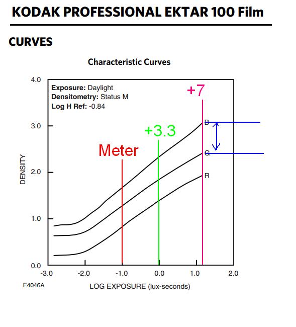

I thought "latitude" was a synonym for sloppy exposure. Amateur color neg films are designed for that scenario. Pro CN films vary with respect to contrast scale and saturation depending on the intended range of applications. A film like Portra 160, for example, has a longer engineered scale than higher-contrast more saturated Ektar 100. Color transparency films have even less usable scale; but they too differ to a degree. The point is to intelligently understand what that is range is, and learn how to correctly meter for it.
138S
Dec 4, 2019
1,776
Pyrenees
Also it is the capability of a film to record a very contrasty scene, conserving texture in the highlights , which is important to depict volumes as glares on the surfaces are important to tell to the human vision how the volumes are, even in portraiture.
Drew, Ektar 100 has an scale that is as long as the Portra 160 one, IMO it is a urban legend that Ektar has a shorter scale, you can insanely overexpose ektar and it will stand.
There is a difference with portra, Ektar is a more landscape oriented film (stili its footprint can be extremly great for portraits) and it has the effect to shift color in the extreme highlights, making a nice aesthetic effect. This effect would be undesired for portraiture as you want the glares in the skin neutral in general.
Simply see the graph provided in the datasheet:
We se that by +7 overexposure ektar is still working, not depicted but it still operates beyond +7 (Each H units in the Hor axis is 3+1/3 stops) , but ektar is designed to have some warming color shift beyond (say) +4 overexposure., while Portra is more neutral in the extreme highlights.
IMO Ektar has not a shorter "scale", but simply it has a design to treat extreme highlights in this way:
https://emulsive.org/wp-content/uploads/2016/11/Skokovic-BlueHourEktar-3.jpg
Source: https://emulsive.org/articles/blue-hour-with-kodak-ektar-100-by-toni-skokovic

Looking at the film itself you will find that slide film has latitude similar to negative film. In practice it might be that such latitude has been more of a consideration in the R&D of negative films, because it is much used in the field. That is especially true for amateur films. Still, in principle there is no difference between E6 and C41 film in that regard.
This is totally wrong, in post 19, Kodak graph shows that Ektar 100 has at least 10 stops latitude. Instead, if you explore the Ektachrome 1000 datasheet you will find that it has a way lower latitude, by a quite large margin:

Have you ever seriously worked with Ektar, Pere? Crossover kicks in pretty bad once you're more than one stop either side of what a typical transparency film does. You seem to be a person quite tolerant of crossover color artifacts. That's fine if it's what you're after. But it's rather misleading to categorize that kind of error under standard norms of acceptable range. Take care and stay well.
Drew, yes, I've been using Ektar extensively, by +3 overexposure for sure you have no shift, see the curves in the datasheet. I usually spot meter and placing the key at +2 (at least) in the cheek by routine.
Like Portra, overexposed Ektar has an slightly different footprint for contrast or saturation, but with Ektar I find no hue shift if not insanely overexposed, say +4 and beyond....
If you have glares at +7 then... yes... you'll you'll get some warming shift....
Anyway with a competent color edition you do what you want, today optical RA-4 is nearly extinguished and once you are in the hybrid you adjust color like you want, with 3D LUT Creator or the like you do what you want...
You may see many exposure Ektar exposure tests posted around, if you find an slight difference from +/-0 to +3 I'll show you how to get the same with a few clicks in PS.
DREW WILEY
Jul 14, 2011
14,304
8x10 Format
Yes, indeed - I see many many Ektar images posted, and indeed tweaked despite significant exposure and filtrations errors - "I can correct anything in Photoshop " - and indeed looking awful ! This film is capable of much cleaner results if it is properly understood. And when output tweaking is needed, masking skills can do it in a darkroom for sake of RA4 printing just as well as PS qualitatively, maybe better - I didn't say faster. But once it's scanned, you have no choice but digital printing too, which I find rather disappointing compared to real darkroom prints, especially when the heavy artillery of large format film is involved.
Now ... the very curves you've posted have decent linearity only over a six stop range, or perhaps 7 stops fudged a bit, which is right around what actual experience with Ektar tells me too. But what you need to do is go to the tech sheet charts which show how the actual spectral sensitivity overlaps - where those three little dye mountains overlap down on the alluvial plain and create mud rather than pure Pyrenees tri-colored water. Once mud is mixed, it's tricky to unmix it.
