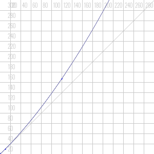

FYI: I played around with the calculator knowing the Velvia 50 reciprocity numbers and it is right on. So, I'll make another chart up for field usage for the E-100. I may not need it as much after all the 50 had a lousy reciprocity factor plus the stop slower than the 100 too. But it will be a sure help when needed in low light.......👍

Thanks Alan. I have been playing around with the calculator and it also seems to be a good item to test with. I base that on the fact while testing it with the Velvia 50 it was almost spot on with my many year cheat sheet I've used. I will also say that I played around with Provia and was truly surprised at that apparently not having compensations needed until between 2 to 4 minutes. I'd heard Ben Horne say upwards of 3 minutes. Quite impressive to say the lest.

Hello Denis. Thank you for your post here. I'll admit I've not used any Ektachrome of any type since my military days in the late 60's. With that said the three e100 photos you have linked are B&W. Were those conversions from the Ektachrome color transparencies or was the link to some of your other fine art scenes?
Although the claim seems to be that E-100 needs compensation after 10 seconds using the calculator looked like it did not start until almost 30 seconds. In comparison to the Velvia 50 and my long time usage the calculator seemed spot on starting at the very low 4 seconds. What was a real surprise was the Provia 100 which was as high as almost 3 minutes. Which also seemed spot on with a comment I saw from Ben Horne sometime back now.
