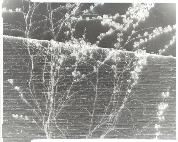

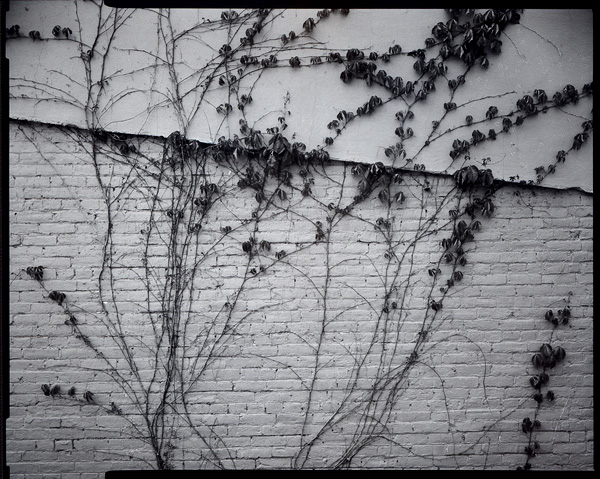

FINALLY developed the paper negatives I was wondering about. They were exposed on 4/29/2012 in Leechburg, PA - USA. 4x5, Ilford MGIV fiber, ISO 3, exposure was 4" @ f16. Toyo 45AII, Fujinon 150mm NW.
So... exposed 4/29/12, developed 4/18/13. I'm just a beginner at making and printing paper negatives... So I will reserve judgement until I can make a print (which should be this weekend). In the meantime I have attached two images. A scan of the negative, I adjusted the levels until it looked like the paper negative to my eye. I then simply inverted that file and save it as a positive.

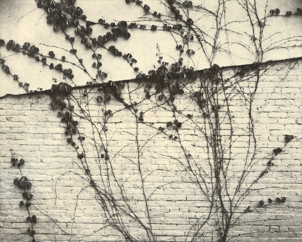

I printed the paper negative in question tonight. There is some vignetting in the top corners, mild, but my memory is too fuzzy from a year ago to determine the cause. The taking lens, a Fujinon 150mm NW f5.6, has more than enough coverage for any movements I might have used. It could be that I forgot to check and see if the the rubber lens hood (if I used it that day...) was cutting into the image circle. It could be from the extended time between exposure and development, or maybe from the paper curling in the holder? I don't know. I do know the prints I made tonight look fantastic! I just finished toning them in tea and am waiting for the wash to finish. =) I will post scans either tomorrow or Monday.

I made prints from the paper negative in question this weekend. I'm attaching a scan of the finished print and it's also in the Gallery. The print is on Ilford MGIV FB, the same paper as I used to make the negative. It was developed in PF130 1:1 and selenium toned at 1:100 for 5 minutes, then tea toned (stained) for 5 minutes.
My conclusion...? I don't know. =) I suspect there might have been SOME contrast lost in the paper negative over the years time but I just don't have enough experience with this process to be certain. I was able to make a print from it that I'm happy with, so that's what counts in my book. Although I think I'll try and get around to developing them a little sooner from now on.
