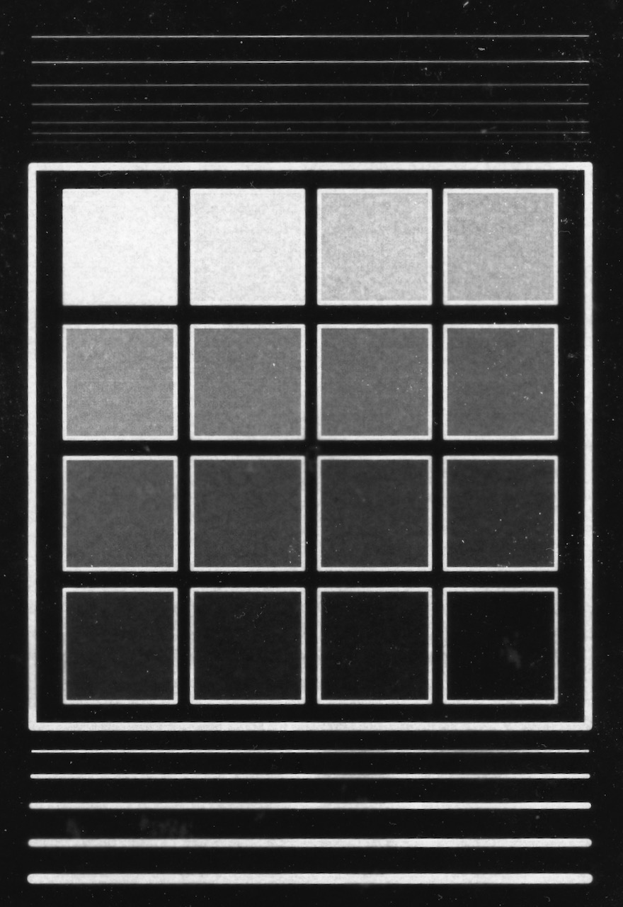

I purchased 170 eur / 200 USD color laser printer and tested to be used on producing digital negatives.
I printed a tone calibration sheet and measured the transform "straight out of the box". I printed on Ilford MG RC V paper on mid-contrast settings.
Here what the paper looks like scanned. This test strip was printed on normal copy paper and I used paraffin to make it more transparent. You can clearly see the paper texture. Printer dithering is also visible but it is not disturbing, quite organic I think.

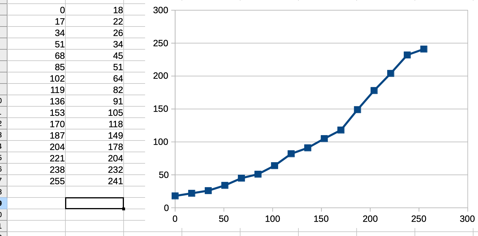

I scatterplotted the input/output and it looks like this:
