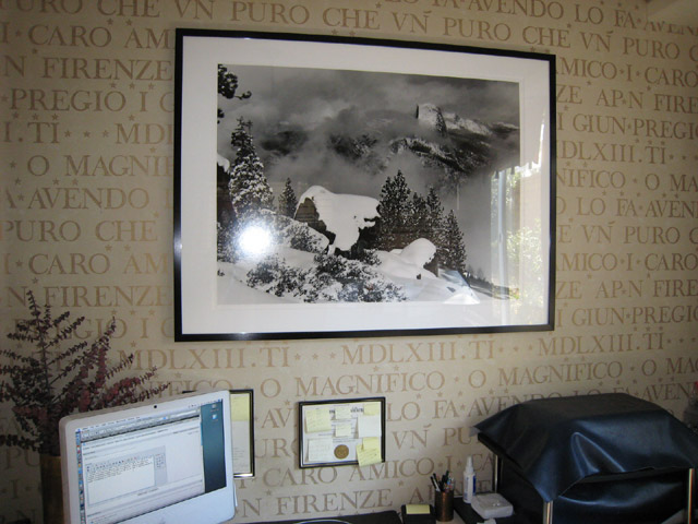

I routinely print medium and large format B/W negatives up to 30" X 40" with a normal wall mounted enlarger (on column) onto a 36" X 48" drop table holding homemade easels of 24"X30" and 30"X40". Anything larger than 20X24 (sheet) pretty much gets cut from 40" or 42" rolls of both graded or VC paper. Processing is in 34" X 44" trays. Of course, one could print 40X50 or 40X60 from the same size rolls of paper, providing enough room to process. Dry mounted and framed normally - like this:
DANGS! You must need quite a bit of room to print that large! Now, if only I had money for that much paper =( Also, how does one source trays as large as 50" long?

You can make a rough wooden frames and line them with thick polythene sheeting, works very well I've done taht a few times.
