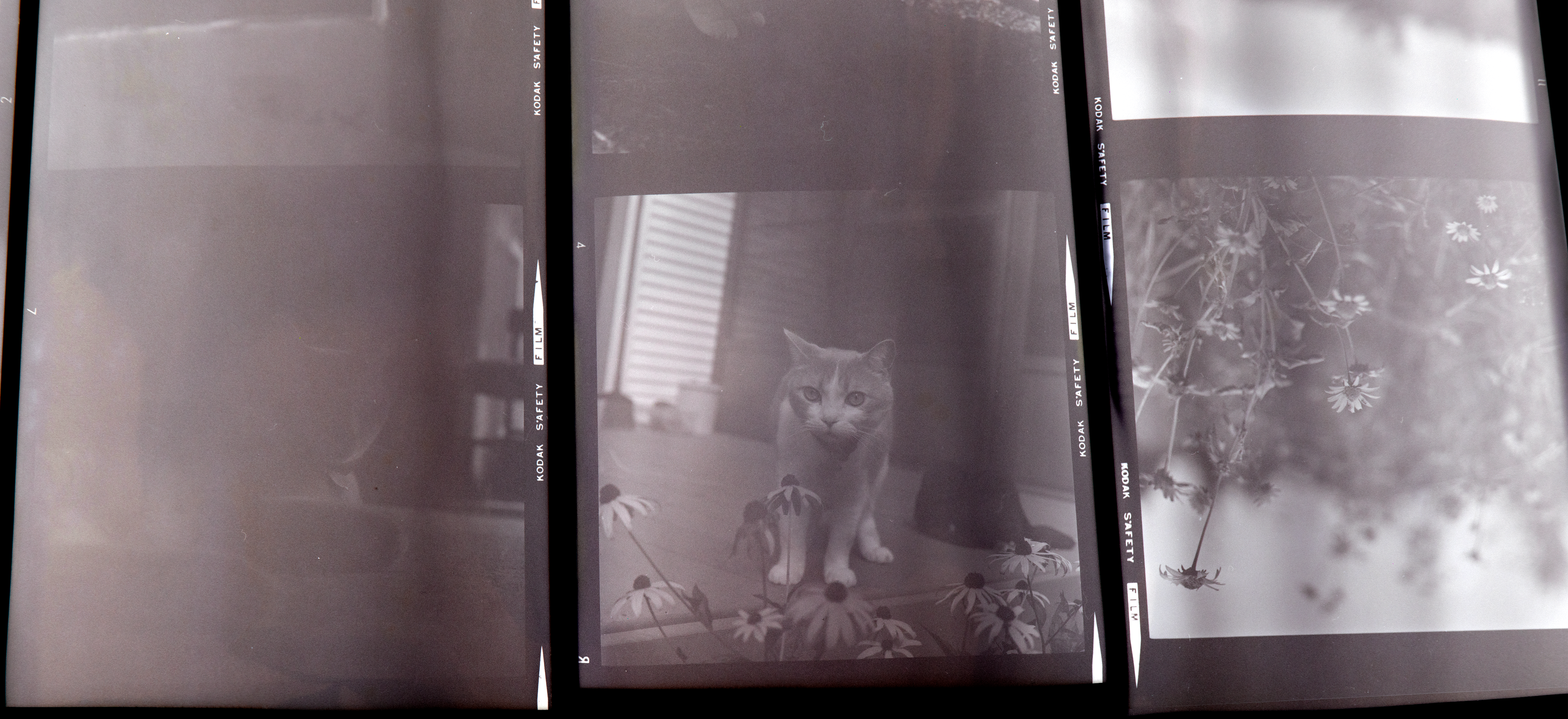

The last 3 rolls I've developed have not gone well, and here's the most recent one:
Yikes. Let me give some background.
This started a couple days ago when I developed an old roll of Tri-X (R9 stand development, 1:100 for 60 minutes). It came out with some wavey lines throughout.
Posted it to Reddit and it seemed like the consensus was that I wasn't agitating properly (I had used the stick that came with my tank to rotate the film), and while I hadn't had this problem before, I decided to agitate by rotating the tank.
I tried to develop my next roll and it came out bad, but this time with a different problem.

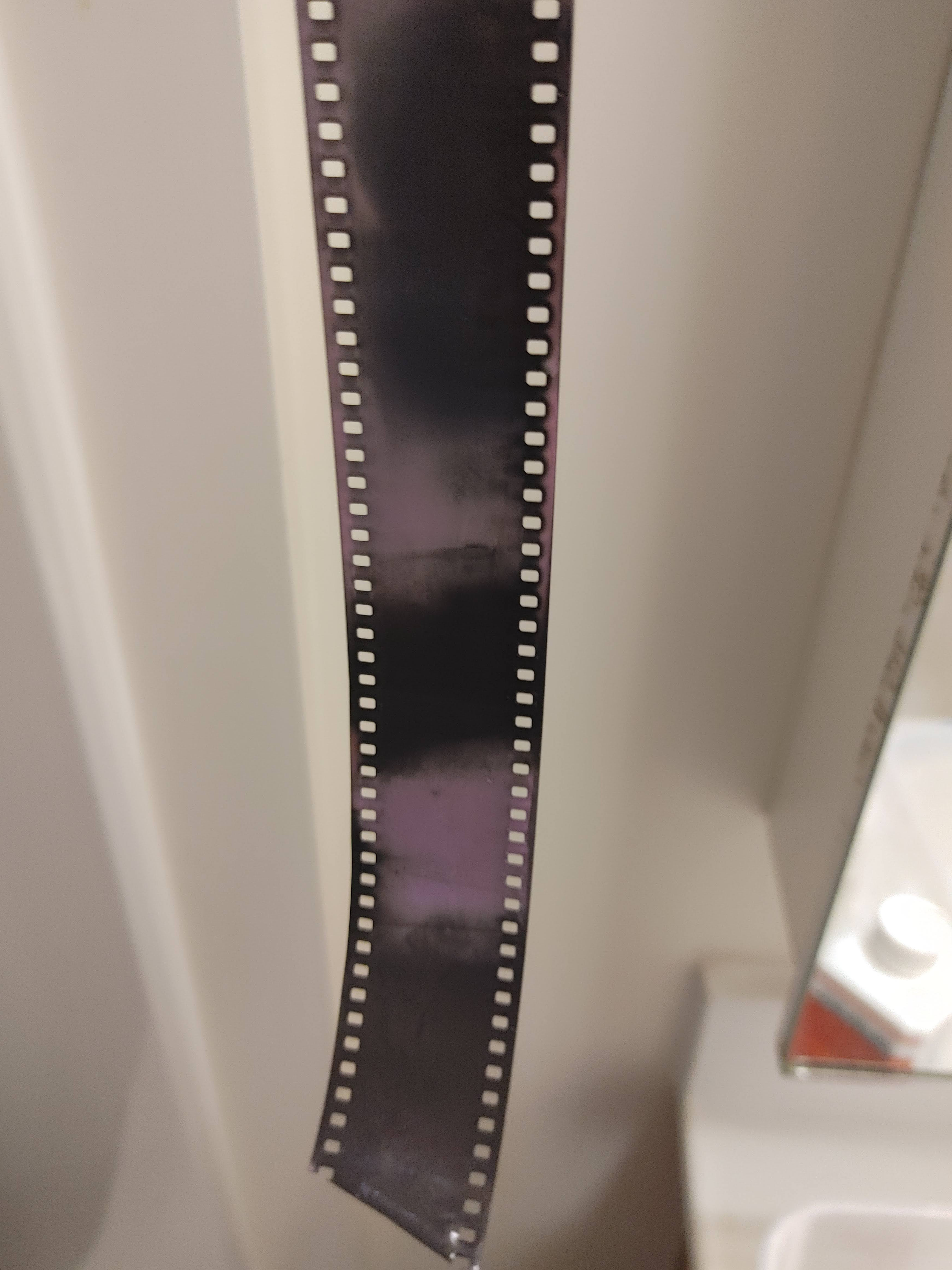

You can see that a large bubble has prevented part of the film from developing. I was pretty baffled by this, I had tapped the tank to try and dislodge any possible bubbles a couple times, but it seems like it wasn't enough.

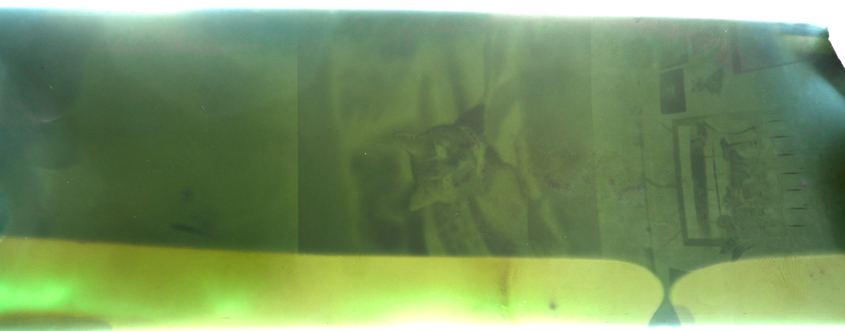

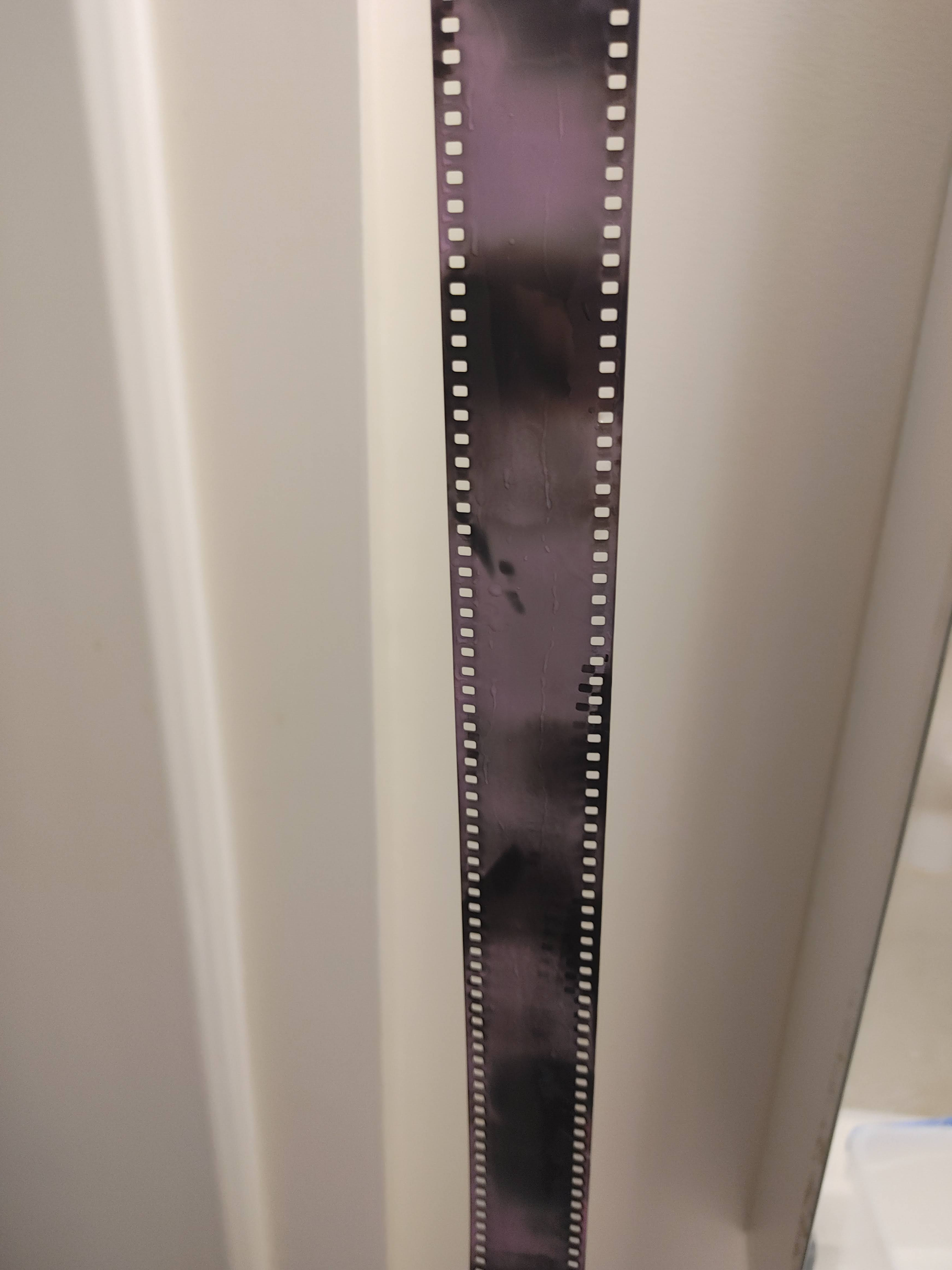

Next I thought I'd try a 35mm roll in order to see if I can prevent this, and this is what I got this time:
It looks like there are large areas of the film that weren't developed. I assume all of these issues are related, but I suppose I could have just had bad luck 3 times in a row? Any thoughts?

Try a standard development time and technique, like 1:25 7 min, 68 degrees and agitate normally.

Seems to me there are massive light leaks.
Also, definitely not fixed properly.
Also, why are you messing around with stand development? There is ZERO advantage with this non-techniqie.

Yes could be light leaking, do you have the hollow central axle piece that the reels sit on in your developing tank? Without it, light can leak in.
Or the film might be touching itself on the reel. Practice loading a reel in the light, you can use one of the screwed up films for that.
Proper agitation isn't rocket science. Three inversions in 10 seconds every minute or something like that and there won't be bubbles if you use the proper amount of developer to cover the reel.
And yes, looks underfixed too. Pay attention to proper agitation in the fixer.
Oh and the streaks on the second film look very odd. Was it x-rayed at an airport by any chance?

How (or where) did you learn to process film? Consistency is an absolute must in the darkroom - as much so with the initial developing of your films as with the printing stage, in the latter case there may be a little more margin for errors as after all you usually work under safelighting and you can at least see where your technique is leading you. Not so with film.
Your film looks developed but fogged to me so I'll go with the light leaks theory, probably in the tank but also possibly in the camera, tho in the latter case you will have noticed this with other films. I also agree with the uselessness of stand development.
You can easily find some excellent instruction videos on film developing if you look online. Even YouTube will guide you to the right way to do it if you search selectively and avoid the more outrageous productions on things like (excuse me for saying it again) stand processing.
You did say you used an old (= expired) film, which may have caused some of your problem. Your film does look fogged. Maybe age-related. Old unprocessed TXP does not wear the years well.

I don't think that stand development is controversial, it just seems unnecessary 90% of the time. W/ your type of problem, it helps to not assume anything. True, it may be fogging from a light leak, it could be bad film or chemicals, it could be a lot of things, so the best thing to do is get back to basics.
Assuming you have checked the tank/camera for light leaks, what I would do is start w/ fresh everything. New film (maybe something bullet proof like Tri-X), new chemicals, and practice loading the film in total darkness or in a change bag. Getting rid of that twirley stick was a good idea, and there's plenty of youtube videos showing proper tank agitation methods.

The disadvantages of course are:
* Risk of unevenness due to absence of proper agitation
* Risk of unevenness due to bubbles
* Risk of insufficient development / low gamma due to insufficient agitation and/or insufficiently available and active developer
* Takes way longer than necessary
So take your pick from these two options:
1: Proper agitation which has been proven to work for over a century for literally millions of photographers.
2: Stand development which, for years, has given rise to at least one thread a week on this forum with problems directly attributable to it.

There looks more at play in first roll than just bromide drag, and light leaks as it looks like there are sprocket hole imprints going at an angle through centre of film - how that happened no idea - but the whole film doesnt look like it was loaded onto reel properly
