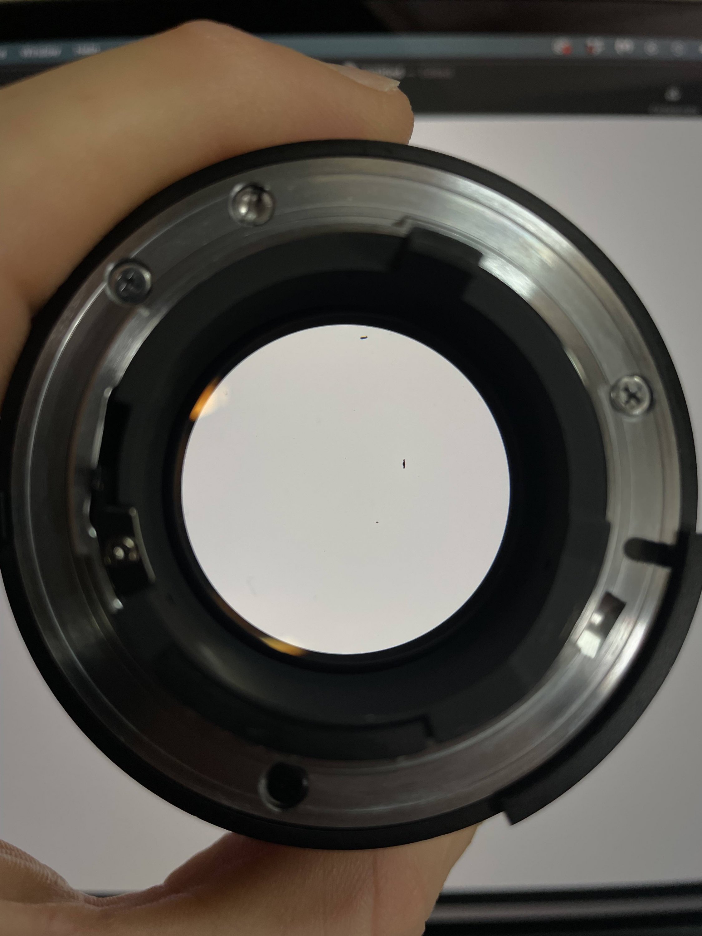

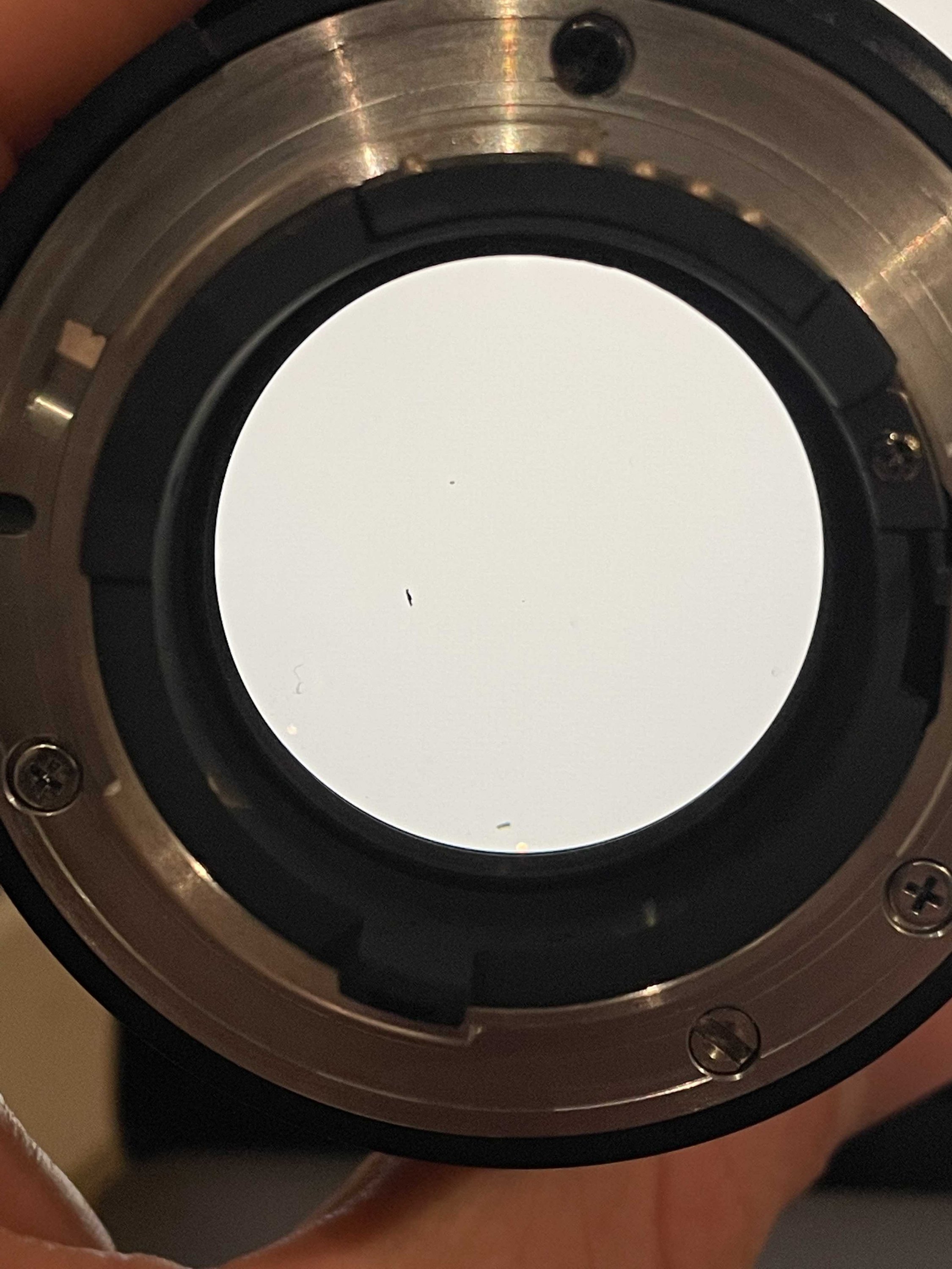

Hey guys,
First post here! Have been lingering in these forums for a while, getting lost in the wealth of information.
I decided I would like to get into film so I've just bought a Nikon FE and a Nikon 85mm f1.8 AF D off ebay. Unfortunately, the lens has two large (dust?) particles in the front element, which wasn't shown in the ebay images.. The particles aren't visible in the viewfinder, so was wondering whether I should be worried about them or not? I don't have a nikon digital camera to test the lens hence why I'm posting. I should be able to return the lens due to the seller not showing nor mentioning it in the ad. So thought I would just get an opinion from you guys first.
Cheers

They won’t hurt anything except for possibly the resale value.
It’s an awesome lens, I like mine better every time I use it.

Those are completely normal (for a lens this age) and will have absolutely no effect on the photographic results.
Don't worry, everything is going to be ok.

Do not worry about it.

Generally, the front element is very far out of focus, so defects on or near the front element are not seen as in-focus image artifacts. This is often less true for the rear element, so marks on the rear element surface are of more concern.
If there are a lot of small scratches on the front, that can cause more light scattering and flare, but a few scratches typically only hurt resale value.

Thanks, everyone for your replies! Appreciate it. That lensrentals blog makes a lot of sense, thanks for sharing reddesert. Now time to shoot my first roll of film!
