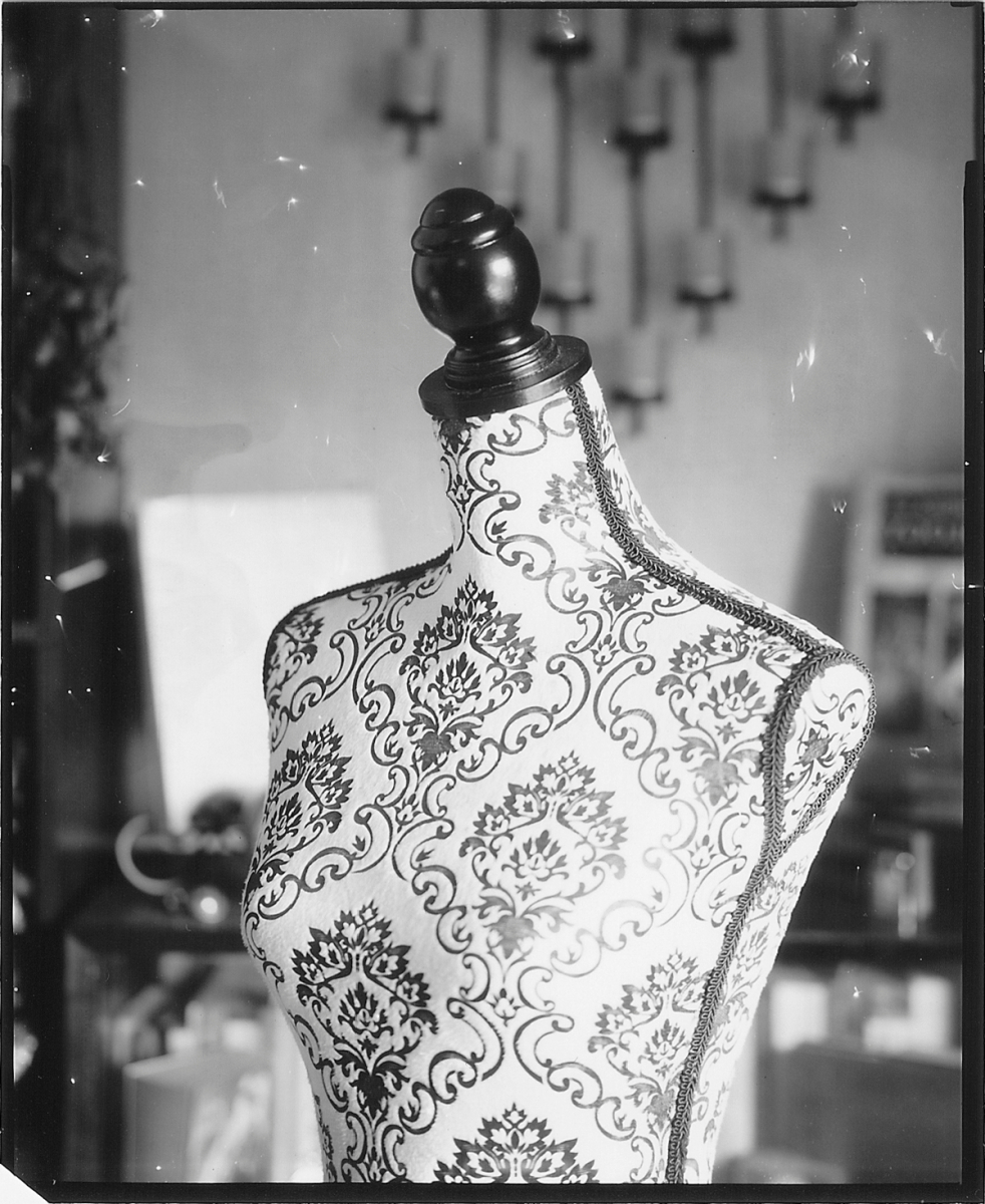

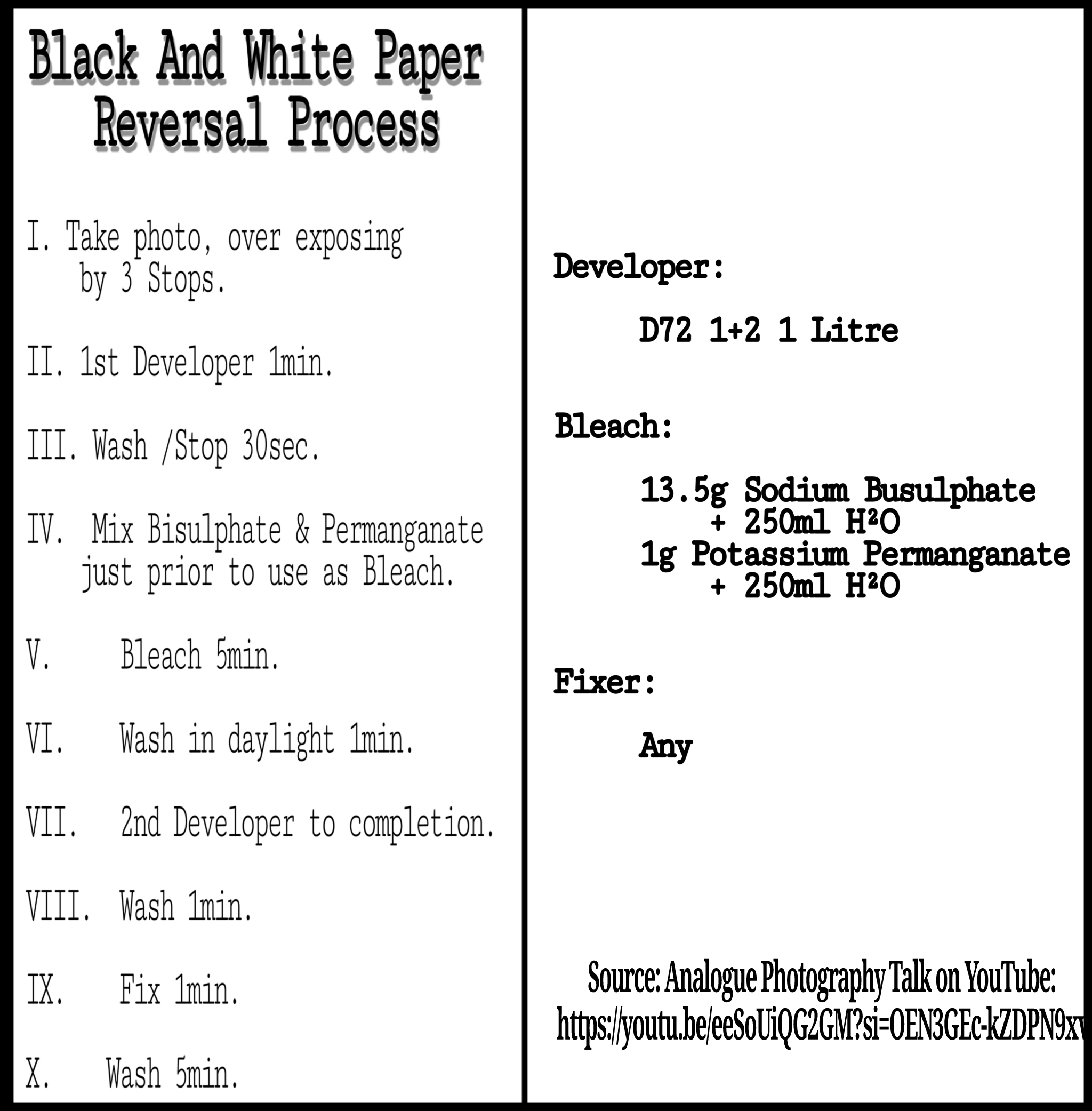

I've made paper negatives in a basic 4x5 Calumet, a 6x9 Folder and a homemade stereo pinhole camera, all then reversal processed using Potassium Permanganate and Sodium Bisulphate (apologies for the typo in my write up!) as the bleach. This is a simplified process I found via "Analogue Photography Talk" on YouTube:
Below are some examples from each camera. The only downside to this process is the need to overexpose by three stops an already slow paper.
The splotches on the mannequin photograph with the light background are what happens if you don't mix in the permanganate fully 😁
P.S. The stereo photo is a) boring and b) not swapped out right to left to work as scanned as a stereograph.
