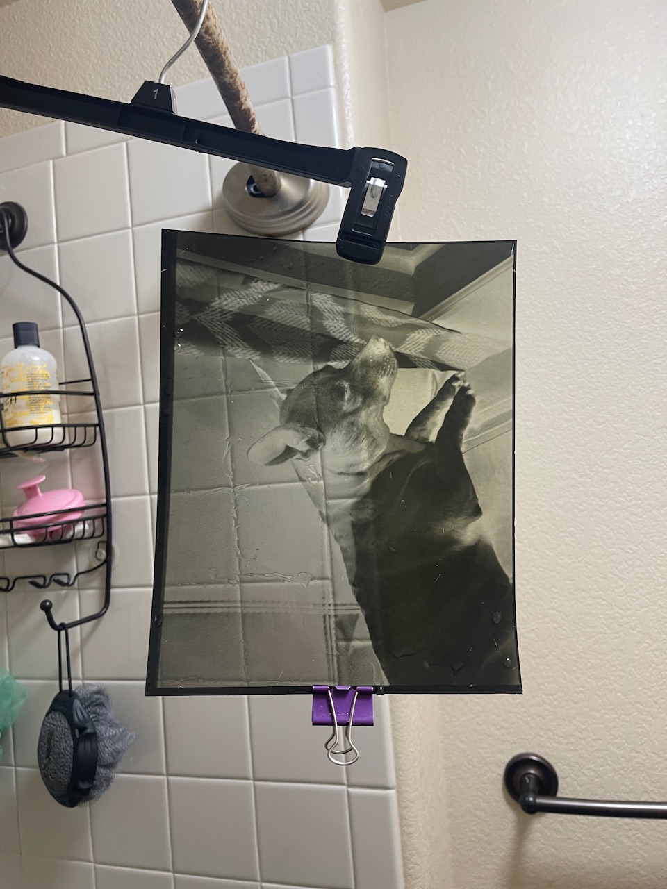

Oh, here’s an example of the film. Direct negative enlargement, turned out very well.
