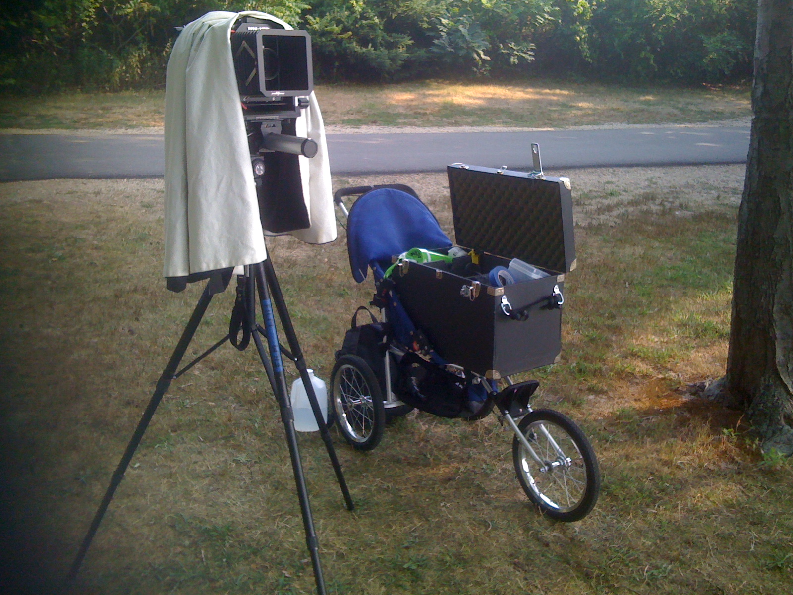

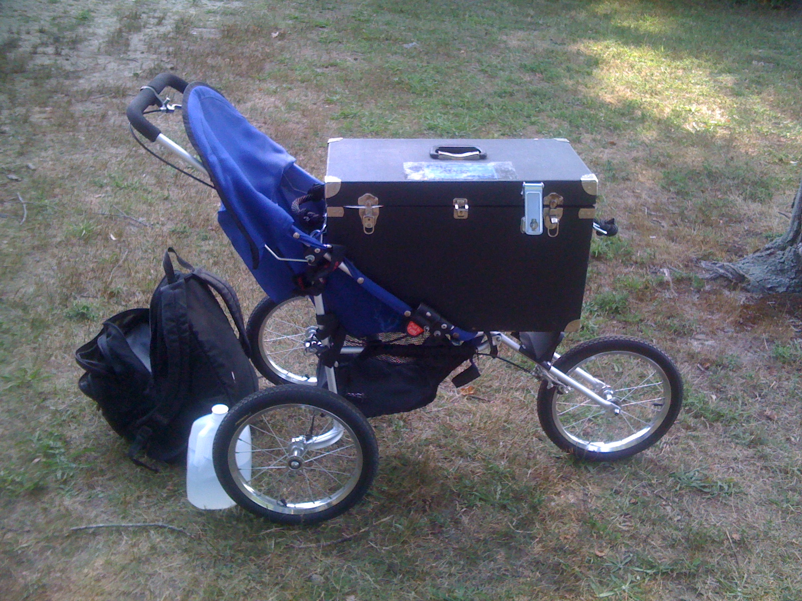

I was severely restricted when using my Omega 45F outdoors.
Then I picked up a used jogging stroller at a Garage Sale ! I've been able
to travel much further, and worked really well when I took it
to Coney Island last year for an APUG MeetUp !
