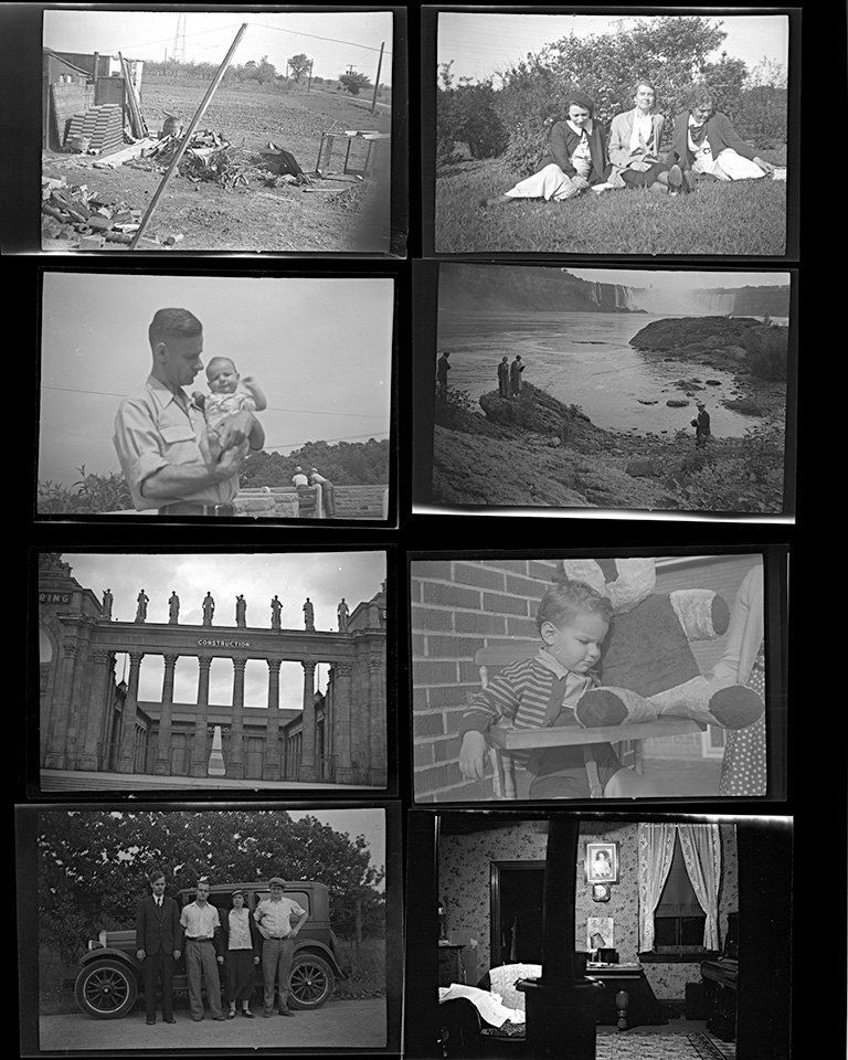

I had the same dilemma with about 500 of my dad's old box camera negatives from the 20s through the 50s. I sorted them into six piles between vertical and horizontal and thin, normal and dense negatives. I then laid them out flat, 8 at a time on my Epson V700 scanner and scanned them at 800 dpi. A little unsharp mask to defog them and this (scaled down) is a sample of the result:
