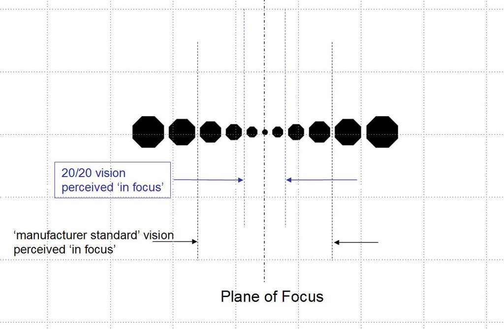

Doesn't it depend on what the OP means by "everything afar" and what his lens and camera format is. If there is nothing in the scene closer than say 35ft and it is a 50mm lens on a 35mm camera then focusing on the far object( mountain) at "infinity" makes sure that even the nearest object at 35ft is also in focus even at f8 so the tree in the example quoted in post #4 will be in real focus as well as the mountain?
What folks are alluding to is that 'perfectly in focus' only happens AT the Plane of Focus. Any deviation at all results in increasingly large 'blur circles'. IF the blur circle is 'small enough to fool the eye/brain' into thinking the blur circle is a 'sharp point' the brain says 'in focus'. But perception of the blur circle being small enough (in focus) vs. too large to fool the brain (out of focus) depends upon the viewer. And a person who just got new glasses is corrected to 20/20 or even 20/15, and will see 'blur circles' rather than 'points' and think 'out of focus' even though the DOF calculator or DOF scale says otherwise. NOTHING other than 'exactly AT the plane of focus' is ever truly 'in focus', so if I move closer to the print I will begin to perceive things to be 'out of focus' where I might have been fooled into thinking 'in focus' at longer viewing distances.
So now, to answer your inquiry, "Maybe!"
  • If I take 50mm lens on 135 format, set aperture at f/8 and focus at 97', even for a viewer with 20/20 vision I will have a DOF Zone from 48' to Infnity.
  • I have to focus at 55' for something at 35' with 50mm lens on 135 format and set aperture at f/8, to see 35' as Near 'in focus' for the 20/20 vision viewer, but Far 'in focus' only extends out to 128'.
Yet the Hyperfocal Distance with 50mm f/8 is supposedly 90'...and my 35' distance object is 'out of focus', as the DOF Zone is 46' - 1538'
