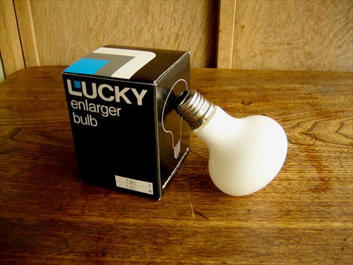

The enlarger is a Lucky 90m but its comes without a lamp, the enlarger uses a
150w/100v lamp. I found one on Rakuten Kenko shop for approximately 20 USD:
http://global.rakuten.com/en/store/kenko-k/item/4944915901693/
This seen to be a picture of the lamp shape
(from here http://utinogarakuta.blog.fc2.com/blog-entry-71.html )
The only lamp I found in my local stores is the PH140 75W and currently I'm
using it to print 135 negatives on 5x7 inches paper. The prints look OK to my
untrained eyes, but without a negative it looks like the center is brighter
than the corners.
I'm thinking about using a PH211/PH212 bulb, because I can get then cheap on
Freestyle*. Is this shape "compatibly" with the one on the picture above? Do
anyone know where to get the correct Lucky bulb for a cheaper price?

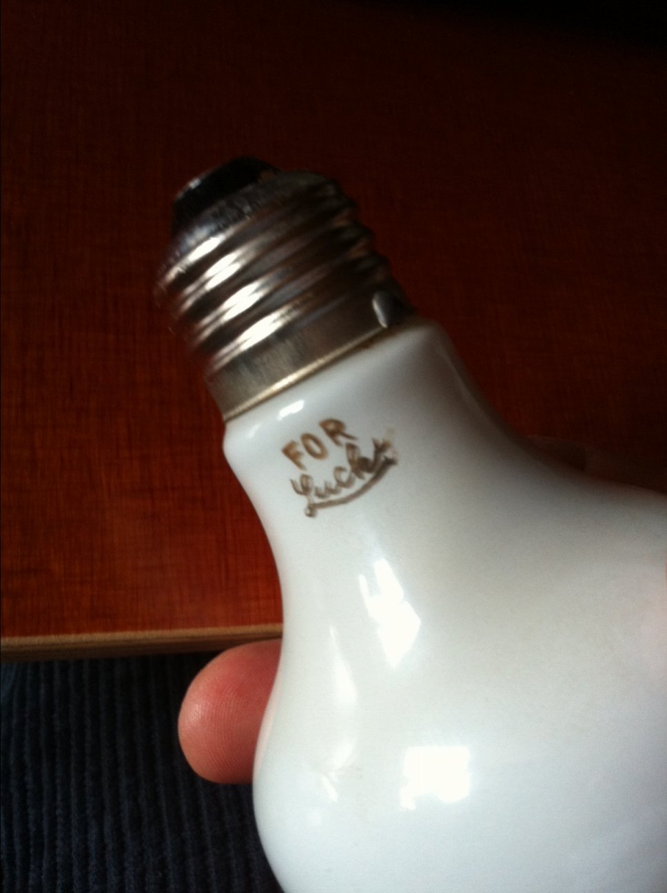

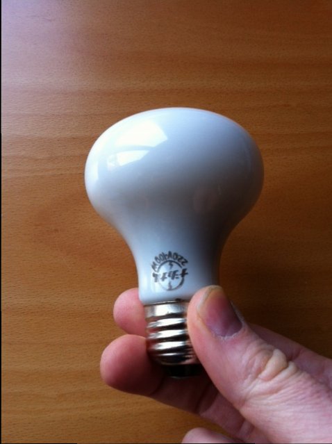

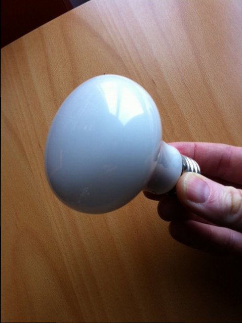

I have a Lucky 60M and it came with a 100 Watt/220 Volt lamp, shaped like a mushroom.
This looks like the same lamp for the 90M (but is a 150W/100V). Do you know where to buy one of these lamps? I only found then on rakuten and they don't ship it internationally.
I also think I can use any brand, but the model/shape is important I used the PH140 lamp you linked but I didn't get uniform coverage, its has visible on some prints.
I'm using the PH211 (the 75W version of PH212)

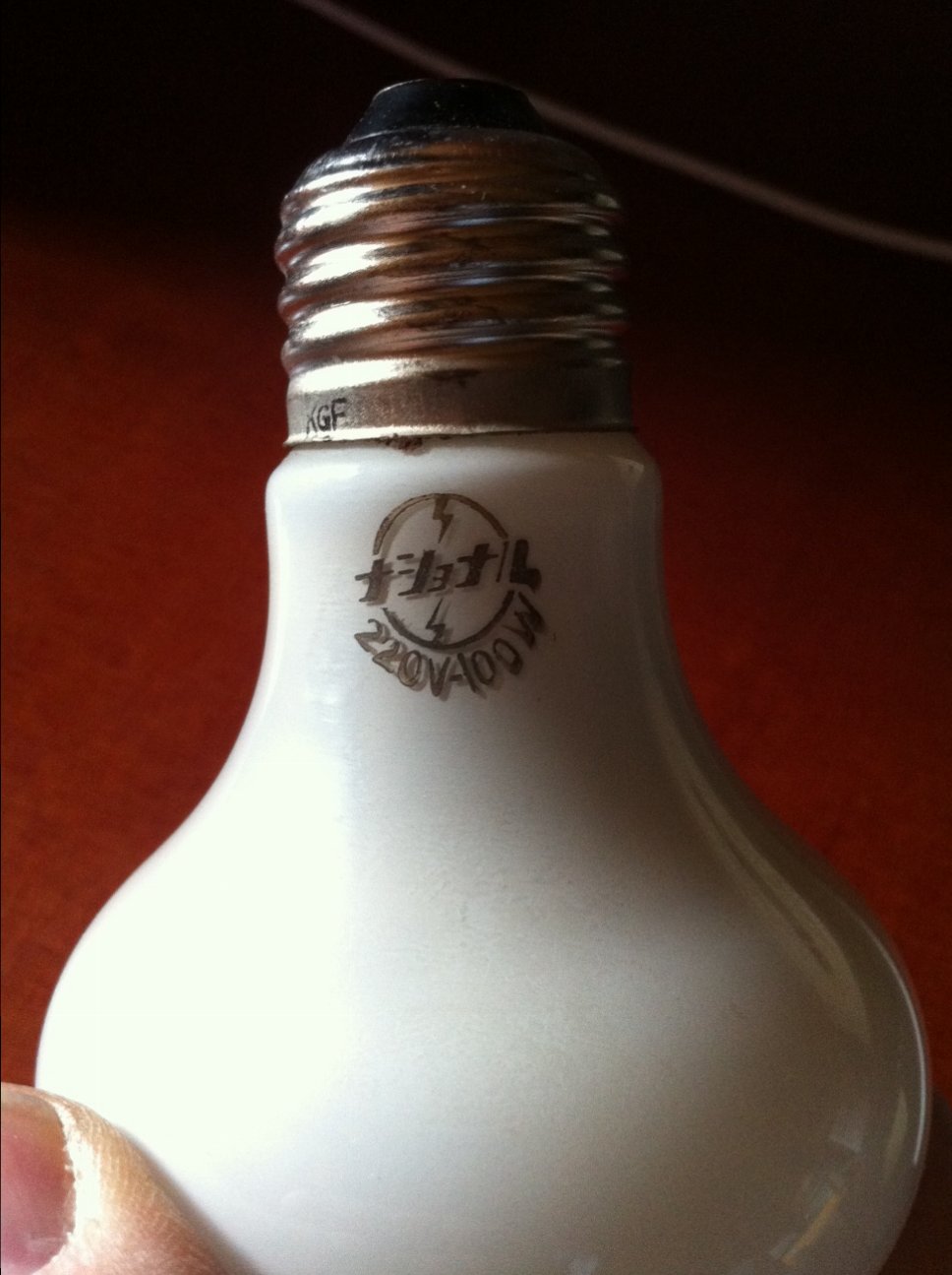

I dind't find this mushroom shaped lamp on ebay, TheToadMen, can you read what is written on the side of your lamp? If I have the shape, like PH211 or PH140, I think will be easier to search for it. Thanks.
One side say: for Lucky.
The other side says 220V / 100 W
There is some sort of writing/ logo, but that could be Japanese writing also??
See images:
The writing is Japanese, ナショナル (nashionaru), meaning "national'. Google don't give me too much, seen to be a brand of Japanese lamps. Thanks a lot TheToadMen, if I found a source of these lamps I will post here.
