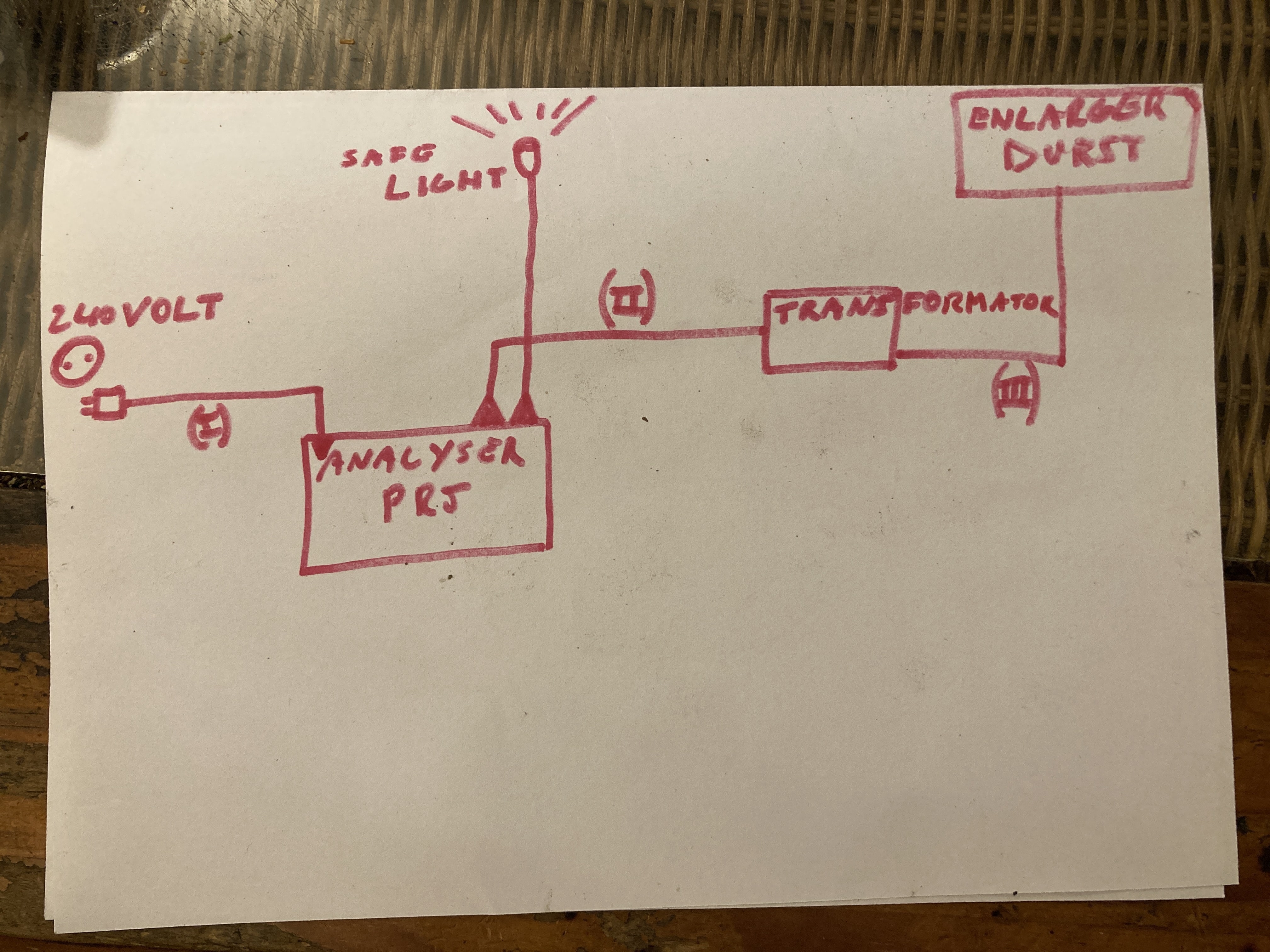

I made a little sketch about it all. Does this sound oke?
Yes! This is how it is supposed to work.
If you had it connected like this when you first switched on the analyer and the bulb died ... nothing to worry about, pure coincidence

Hi
Thank you very much. I will try it right now. Just bit nervous about it. I will let know if it worked.
