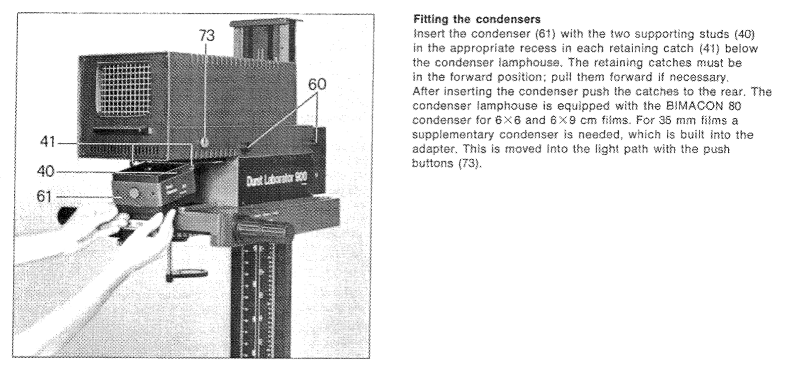

Are you aware that you will need 3 sets condensers? For 6x9, 6x6 and 35mm (or for whatever format you will print).
That is what I have for my Durst M800, not sure that L900 is the same, but they are about from the same era.

Good news! All condensers are supplied as well as lens holders.

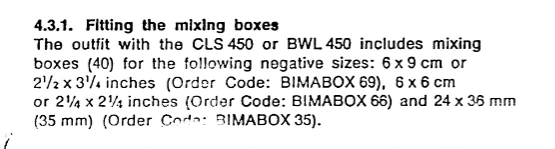

Yep, and 3 mixing boxes for different formats to work with diffusor head BWL 450:

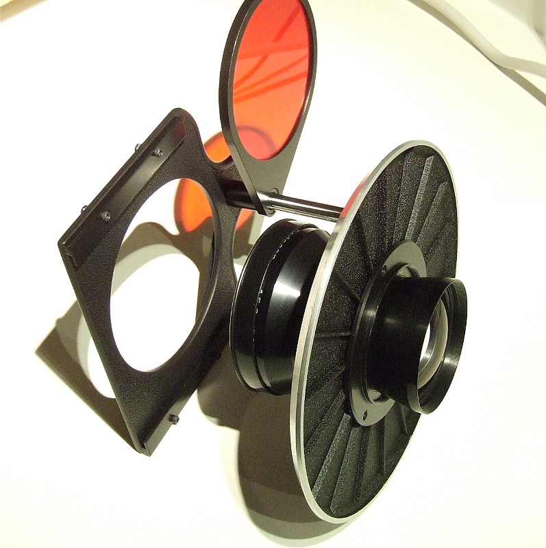

I can mount an additional drawer for multigrade filters?
When I used under the lens filters, I just took a bit of copper electrical installation wire, bent it into an appropriate shape to make a 'filter holder' and put the filter there. Just to illustrate that you can make this as simple as you want. Or as complicated! But fitting a multigrade filter under a lens ain't rocket science. The closer you mount the filter to the lens, the smaller its potentially negative impact (due to dust & scratches) will be on image quality as you'll take any defects on the filters as far as possible out of the focal plane.

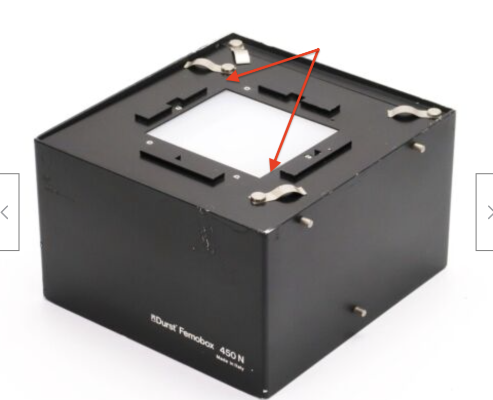

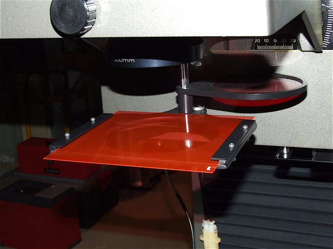

My Durst at one time had a 10x10 inch filter holder above the negatrive. Since those filters are very expensive, I made an under-lens holder for the smaller 6x6" filters. You could do the same or maybve just lay the filters on top of the FEMOBOX diffuser.

You can place filters on top of the Femobox. There are extra clips to hold the filter in place.
