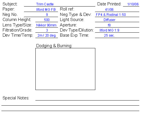

Peter sent me an Excel file that cotained a template of what he uses. I attached a portion of it here. The file contained four labels per page.
(Thanks Peter, that is just what I was looking for. I tried replying to your email but I got an error message saying it could not go through)
I will modify it a bit for my purposes. I don't have
a darkroom since circumstances limit me to shooting
4x5 E6 and scanning them.
I will have to go out now and buy some acid free
labels in that size. Do you happen to have a product
number to recommend?

I use labels made by Apli, ref code 1280. The label is 148mm x 105mm and there are 4 labels on an A4 page. They are probably not archival but I only stick them to my preference print which I refer to when printing from the same negative in the future. I may not get an identical print again but the information gives me a good starting point.
Peter
