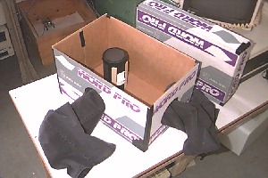

Back when I was doing lots of pinhole photography I used a DIY changing box. Black pant legs taped to the openings of a cardboard box.
