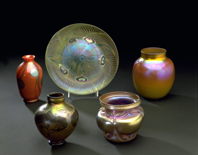

I am researching Tiffany Glasses and his chemist Arthur Nash Inventions. I am having very hard time with Corning Glass Museum. I bought Arthur Nash Notebooks Book and learned that When LCT at France , he inspired with thousands of years old Glass Vases which they remained in wet soil for a long time and turned to gold color after acids eat the alkali and preserve the silica.
Before invention of Favrille , they applied to the blowed glass vases , atmospheric carboxyl acid and get the same shiny , deep , thick and metallic luster.
I asked some questions to British Museum and Corning , but I am speaking to walls.
I looked to A.C.A. term at Google and found many different relatives. I dont know what is the exact chemical , is it dangerous like hydrofluoric acid , how to apply , what is time requirement for process and does lustered glass cancerogenic.
If I learn the process , it would be possible to print on glass or print on ceramic glassy glaze.
I added Favrille Glass example but preFavrille luster was faraway stronger.

Can you find an example of the pre-Favrille glass? I'd love to see it.
Maybe contacting some kind of art & design school that specializes in glass would be more fruitful. Companies will never be helpful; academic types would be much more willing.
Are you trying to find the specific carboxylic acid used?

Prefavrille production was not so strong if I am not wrong and quickly turned in to a technology contains silver adding in to molten glass than make a vase than put in to kiln and heat it in special atmosphere , when vase turned in to green - when silver out from the glass - protochloric tin sprayed and tin turn in to gold color as at the picture.
I have preFavrille pictures BW but it looks wild really.
