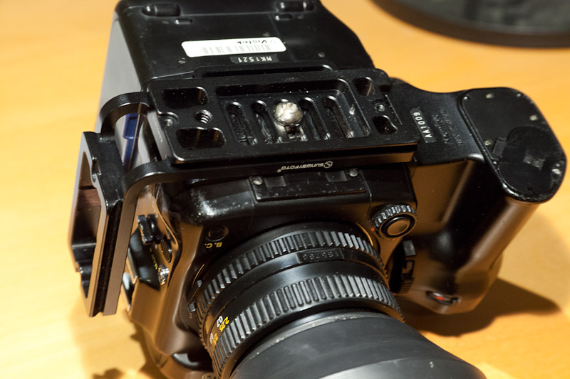

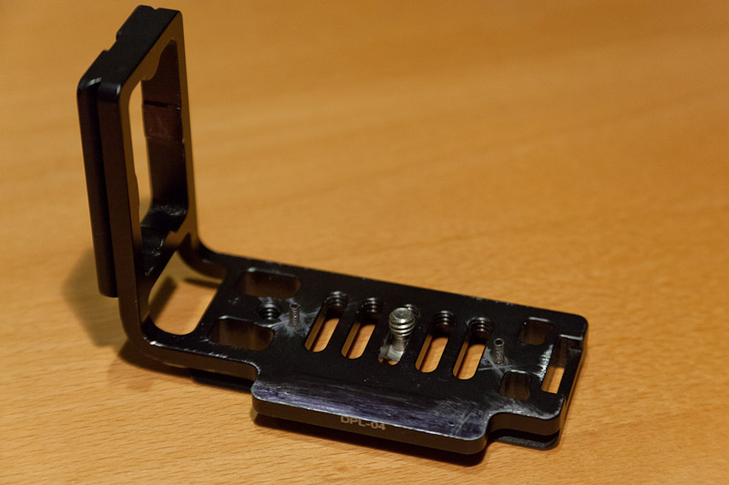

Hi Howard,
I bought the Sunwayfoto DPL-04 Universal L-Type Quick Release Plate from B&H and modified it for my Mamiya 645 Pro. The modification was to grind off the ridge at the back, drilled two holes for anti-rotation pins and cut out the piece in the vertical portion of the bracket. It works like a charm and the Sunwayfoto L-brackets aren't too expensive. Sunwayphoto has a few more universal models that might work better for the Bronica. The Sunwayfoto website provides mechanical drawings that are very helpful. I copied the DPL-04 drawing to MS Visio scaled it and printed it such that the drawing on paper was the exactly 1:1 so I could see how it would would work on the camera.
The anti-rotation pins are M4 headless socket bolts from Ottawa Fastener Supply. After I mounted the bolts, I filed down the thread so that it wouldn't cut into the plastic of the bottom plate of the Mamiya. Overall it turned out well and the whole setup it pretty sturdy. The Sunwayfoto brackets are made of a good quality aluminium.
If you need more info or would like to see the real thing, let me know.
Menno
