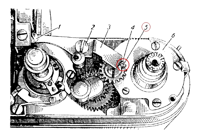

Well, I got the top cover off and got the pentaprism fixed, but I can't repair the mirror mechanism. There is a tooth on one of the winding gears that actuates the mirror lever and it is broken. So unless I can find a replacement gear that is FUBAR. I can still cock the mirror manually if I remove the lens first, but other wise it's not working.

Look at page 38 of the link I sent you. One nice thing about brass gears is that they're repairable.

This is the gear that has the pin sticking out of the side so that as the gear turns around, it pushes the arm at the right time. Unfortunately, it is made of pot metal and breaks real easy. In the illustration it is the pin (5) on the gear (4) that pushes the arm (3) as the gear rotates clockwise when winding the film. So I'd need a replacement gear because there is not enough of this pin to push the arm far enough, and I don't even know if it is possible to even find one anymore for this camera.
