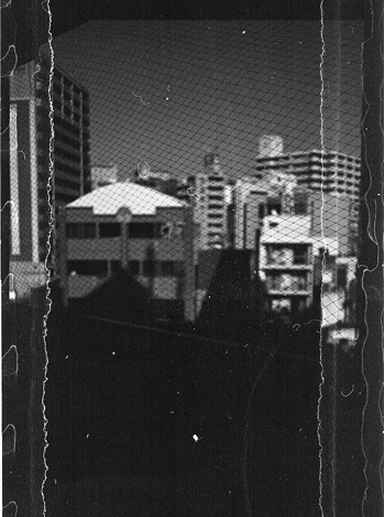

So the other day I came across almost 10 rolls of Kodachrome 64 I still have. They've been in a freezer since they expired about 2 years ago.
I'm afraid of messing up Caffenol and blowing up my house, and I heard D-76 might work, so I tried a quick clip test (10 shots) with my OM-2 and some (not fresh) ID-11. I shot it at ISO 50, and developed it for almost 10 minutes.
I used water as a stop-bath (I'm going back to acid soon) and noticed the water came out brown-ish. I'm guessing this was the antihilation layer coming off? (I'm not that familiar with KR.) The white lines across the sides seem to be remnants of that layer.
The film came out quite under-exposed, so perhaps shooting at a higher ISO and/or changing developing times would be in order? Next time I will definitely pre-wash, I think that'll eliminate any nasty stains.

Kodachrome has a remjet backing, right? That's probably what was glopping off in the stop water.
If it was underexposed, I think you want to set your meter at a lower ISO, not higher, if you use the same developing time.
All in all, that seems like a fairly usable imaging process, I'm impressed.

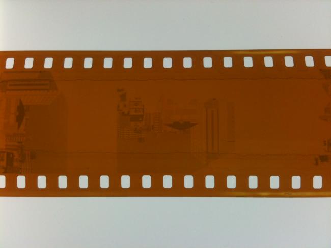

Thank you for the advice :smile: This was a seat-of-the-pants, spur-of-the-moment experiment, so it was pretty un-scientific. I've attached a photo of one strip on a small light table. The lines down both sides are from the "remjet" then. They're not very thin (like Acros) but I was impressed by the density (I was expecting nothing.)
I was dumb and developed the KR64 along with a roll of Kentmere 400, which developed water spots (more than usual.) I was unaware that anything would come off :sad:
I'll try shooting at a lower ISO, maybe 25? The film expired in June 2008, but being ISO 64 to begin with and kept in a freezer all these years, I thought 50 would be okay. The problem is finding a camera with a meter that will go that low :whistling:
Edit: will a pre-wash with just water, or water + dish soap remove the remjet? Finding chemicals/knowing what they're called in Japanese is a little difficult (I only just the other day learned the word for "baking soda")

Are you sure it is completely fixed? It's hard to judge from a scan but it might look a bit milky... I may be wrong.
I think my fixer is close to exhaustion. I'll be making a fresh jug this week.
I've been using Chugai My Fix for a while now, but I might go back to Fuji Superfix as it lasts longer.
As a multi-layer color film it may take longer to fix than normal BW films.
