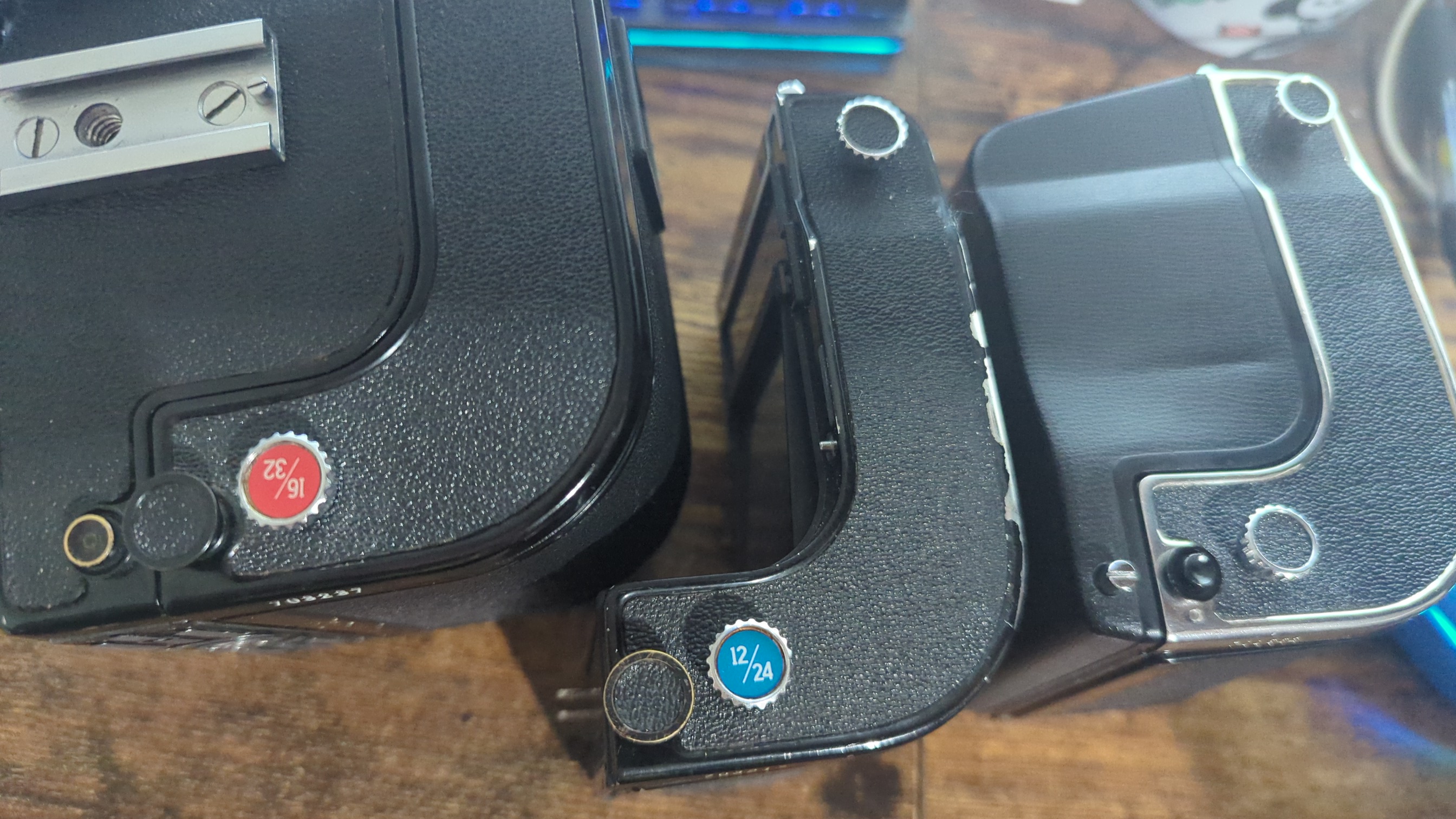

Hi Paul! No, it's still the Kowa Super 66, but it uses a 645 back, I'm not sure if the docs for the 66 system call it a 645 or 16/32 exposures.
In the picture I attached it says the number of exposures on the little dial near the open button.
16/32 for 6x4.5 and 12/24 for 6x6.

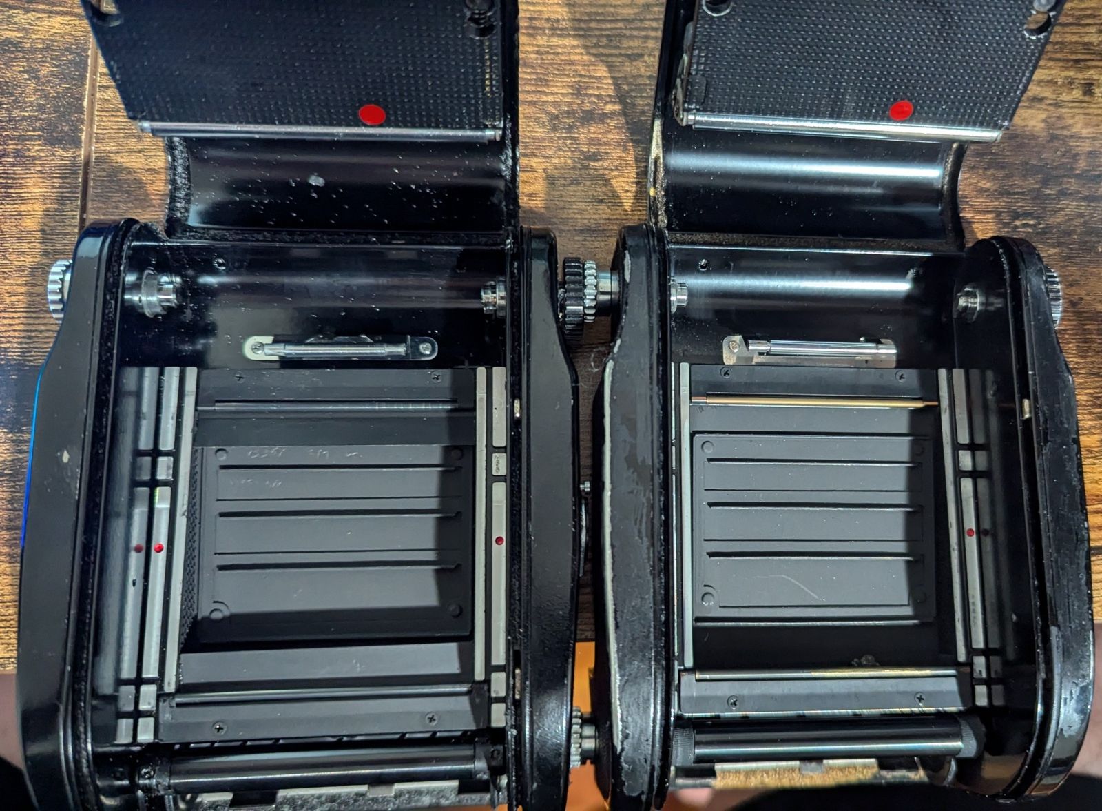

I thought this was interesting, so I took a pic. I figured they would mask it here, but I hadn't looked. I think the more I play with this camera the more I like it. I would like a hand grip, but I don't want to pay 100 bucks for one.

@AnselMortensen these backs can be found once in a while on eBay. This one in good shape was like 80 bucks. Same idea for the kiev 88s, I think those might be even more rare.
