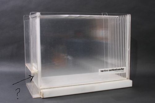

I just got a used Kostiner Archival Washer for 11 x 14 prints. There are not any inlet or outlet devices. I have difficult to understand how it works and what is the flow of water inside it. There is another hole also, a vertical small pipe in the same side than inlet and outlet. Should I put a valve for the outlet and control the level of water with it?
I'm confused. I need advice. I can't find nothing about the way to use it.

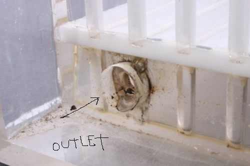

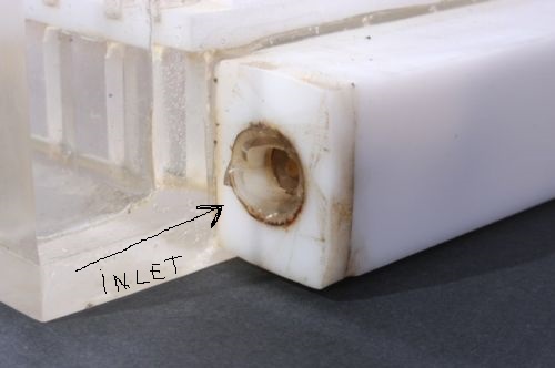

Somes pictures of the Washer.

You have the correct labelling. Given that your inlet device has broken off and the air inlet feature is optional, I would just tap for a hose and use the water faucets to control the rate of flow.
The exit similarly is just a straight hose but with a shut off valve. the valve is used to empty the tank at the end of the day and is closed during usage. Water is allowed to spill over the top during washing.

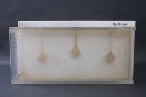

Well I examine more closely my washer. In my first picture, where I didn't know what was this small tube. It is the drain for the overflow. So I understand now how it works. My main problem I realize yesterday concern the ''water distributor'' at the bottom of the washer. It seems that during transport, these distributors were detached from the main inlet ''channel''. See the picture. I'll found a glass/acrylique/plexisglass shop to open the bottom of the tank, fix the tubes in a proper position and reglue everything. In the picture, we see the positions of these items but now, I just have one OK. The 2 others are displaced.
