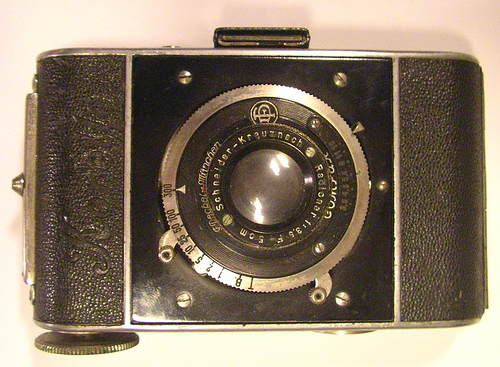

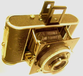

The Kochmann Korelle 3×4 camera was a little folding camera for 3×4cm exposure format. Nowadays it reminds us of modern compact cameras despite of it's heavyweight cute metal body which is covered with leather or leatherette. As a viewfinder the camera has two frames which unfold into view-through position by pressing the camera's unfolding button. A version with a little optical viewfinder and an accessory shoe was available.
Year of release: 1931 (or 1930?)
Manufacturer: Franz Kochmann
Film Format: 3×4 cm
Type: folder camera with simple two frame viewfinder
Shutter: Compur shutter (by F. Deckel, Munich), exposure times 1 sec. down to 1/300 sec.
Lens: Schneider-Kreuznach Radionar 1:3.5/5cm
Aperture: 3.5 to 16
Dimensions: circa 12 x 7.5 x 4 cm (folded)
Oct 29, 2006
4,829
İstanbul
May be your camera is similar to above ?
or this ?

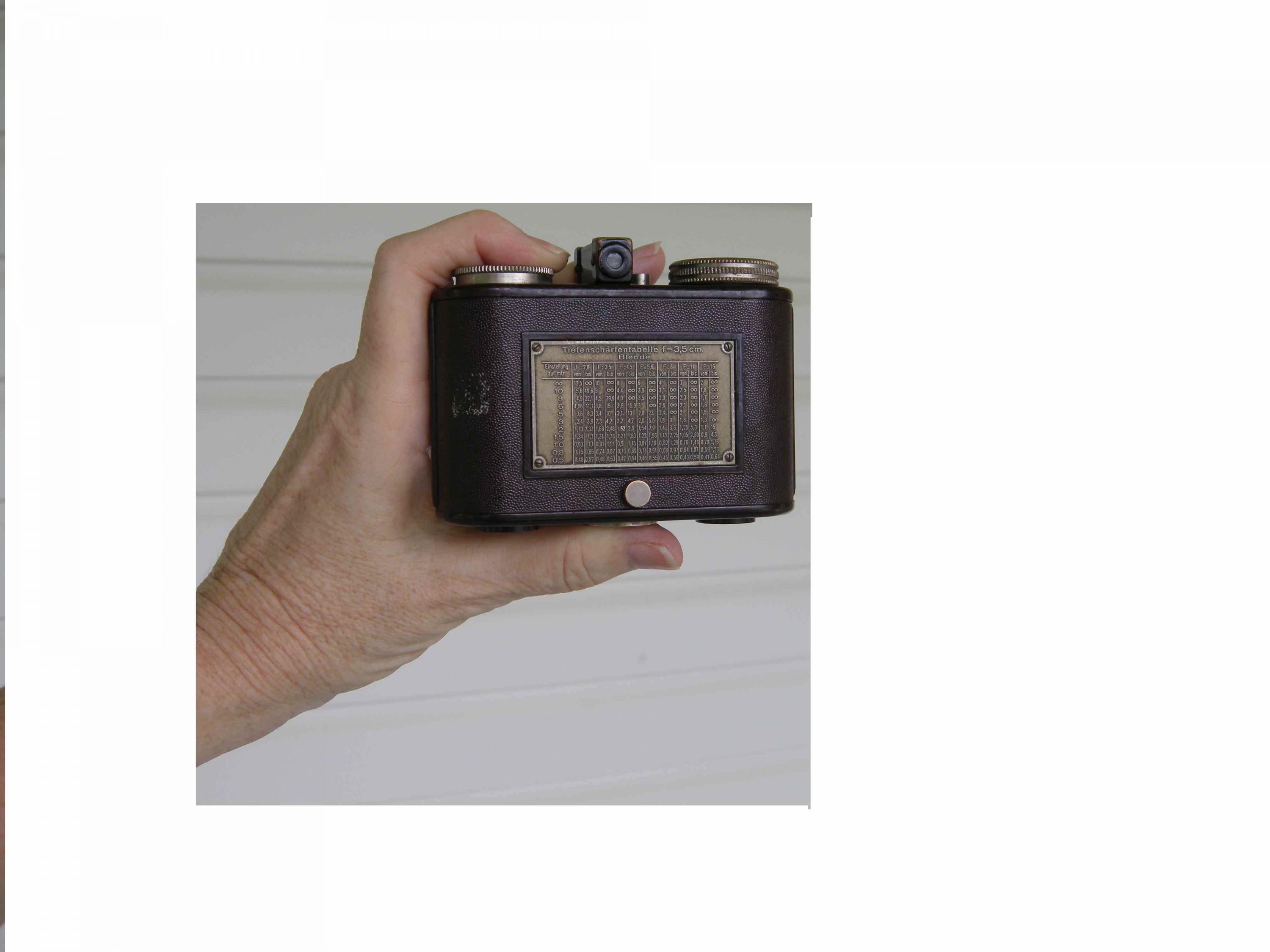

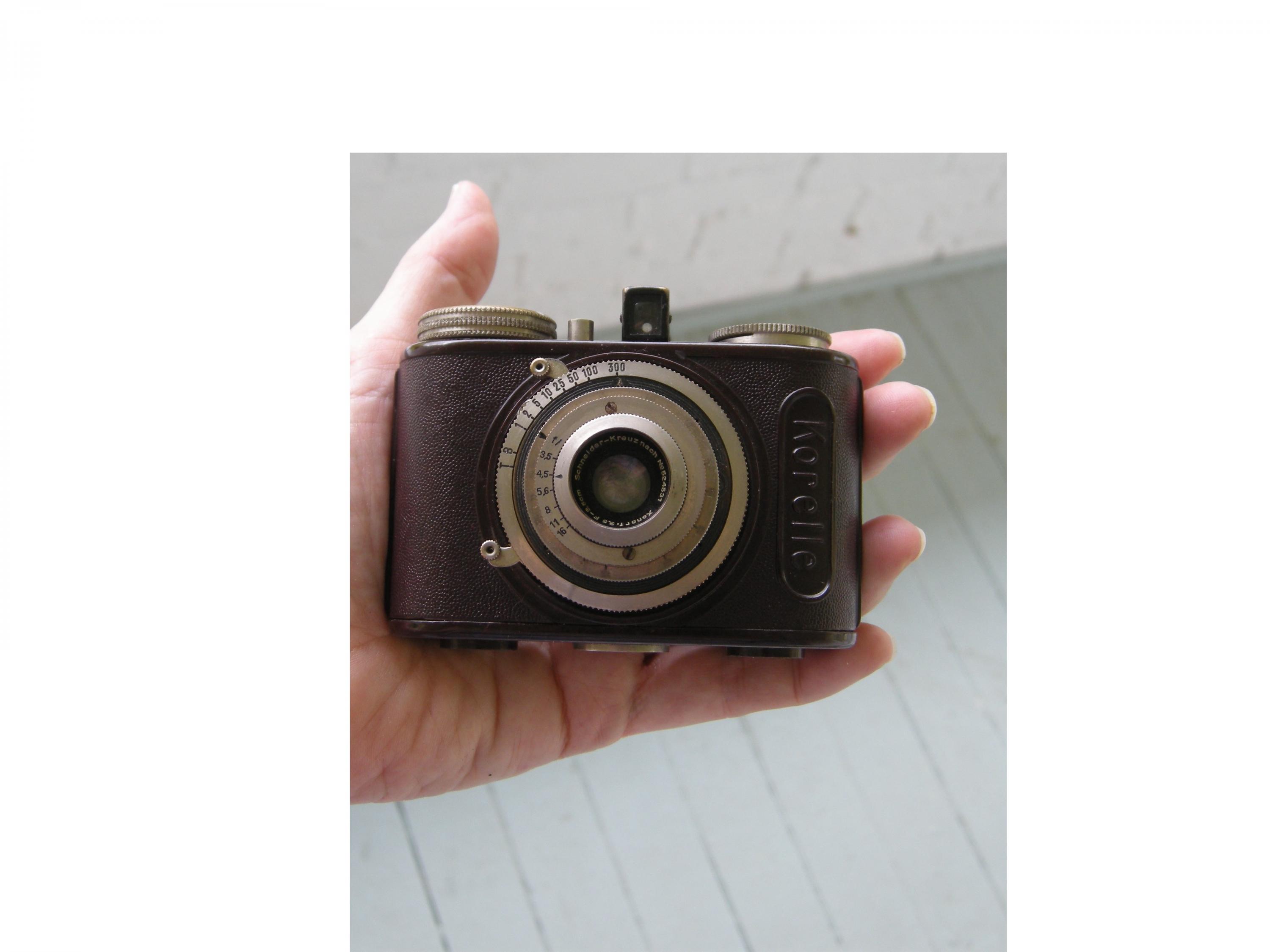

Firstly, I wish to apologize for not sending photos of the camera first. I took some pictures today and will attach them.
Secondly, I just found an answer to my question which was "How does one open the camera?" There is a gentleman on Ebay selling one-or he was-and I asked him if he knew how to open his. He did not at first but said he would notify me if he found out. He just responded with the following instructions:“You loosen that screw, then hold it facing down and the bottom towards you. Use your thumbs to push down and toward you while pushing forward with your other fingers. That did the trick for me. Found a roll of film inside!- sloenich1”
Yes, I have also read that it has Leica lenses on some models but mine has a Xenar. It is a small,solid camera feeling camera and i like the round sides.
Thank you all for your time. I hope the pictures of this camera help. I'll put up photographs taken with it if the camera works
