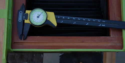

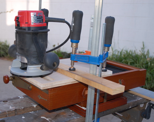

The Folmer & Schwing arrived today. Wow. Workmanship is incredible and it's *tight*. Smooth and silky focus using the big wooden knobs. Only problem is that there is no rib-lock channel in the back. I'll have to rout one if I want to use my S&S holders. I have an ancient holder with no rib, and the camera came with a no-name holder in fine shape that has a small rib moved far enough down the holder that it engages the inside of the back, not a channel. Kinda hate to make sawdust from this queen, but if I'm gonna burn Efke, I'll need all my holders. Scan of first image(s) to follow.

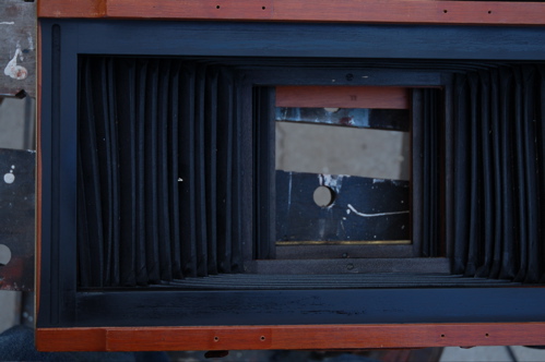

It's done. I posted 3 photos of the setup and the finished groove. In addition to the lack of a groove, the holder area was stained wood, where I prefer flat black paint. The S&S ribs are not tall, so a shallow groove sufficed. The old carpenter's adage "measure twice and cut one" was far outdone today, as I must have measure 15 times before I attacked this antique with a 17,000 rpm bit.
Here are the three photos, for those whose interest exceeds their initiative to go to the gallery.

Nice job!

In my opinion it is much better practice to put a groove in the camera back rather than attempt to alter holders. For one thing, you make one change on the back, and that is it. If you mess with the holders you have to alter them twice for however many you have.
The F&S is a great old camera but very much an odd-ball with regard to the rib on the camera back and the groove on the holders. The only reason to stay with the original configuration, IMO, is if you already have three or four F&S holders and simply want to add one or two more.
Otherwise, just change the back. I am surprised how many people feel that this is somehow mutilating the camera. In fact, most F&S cameras that I have seen have already been so altered because F&S holders are very rare.
The only time I would recommend not doing this would be in the case of a camera in Mint+ condition that would have more collectible than user value. I actually had a Korona like that at one time, and sold it because I did not want to use it and destroy the value. But very few banquet cameras are in that kind of condition.
