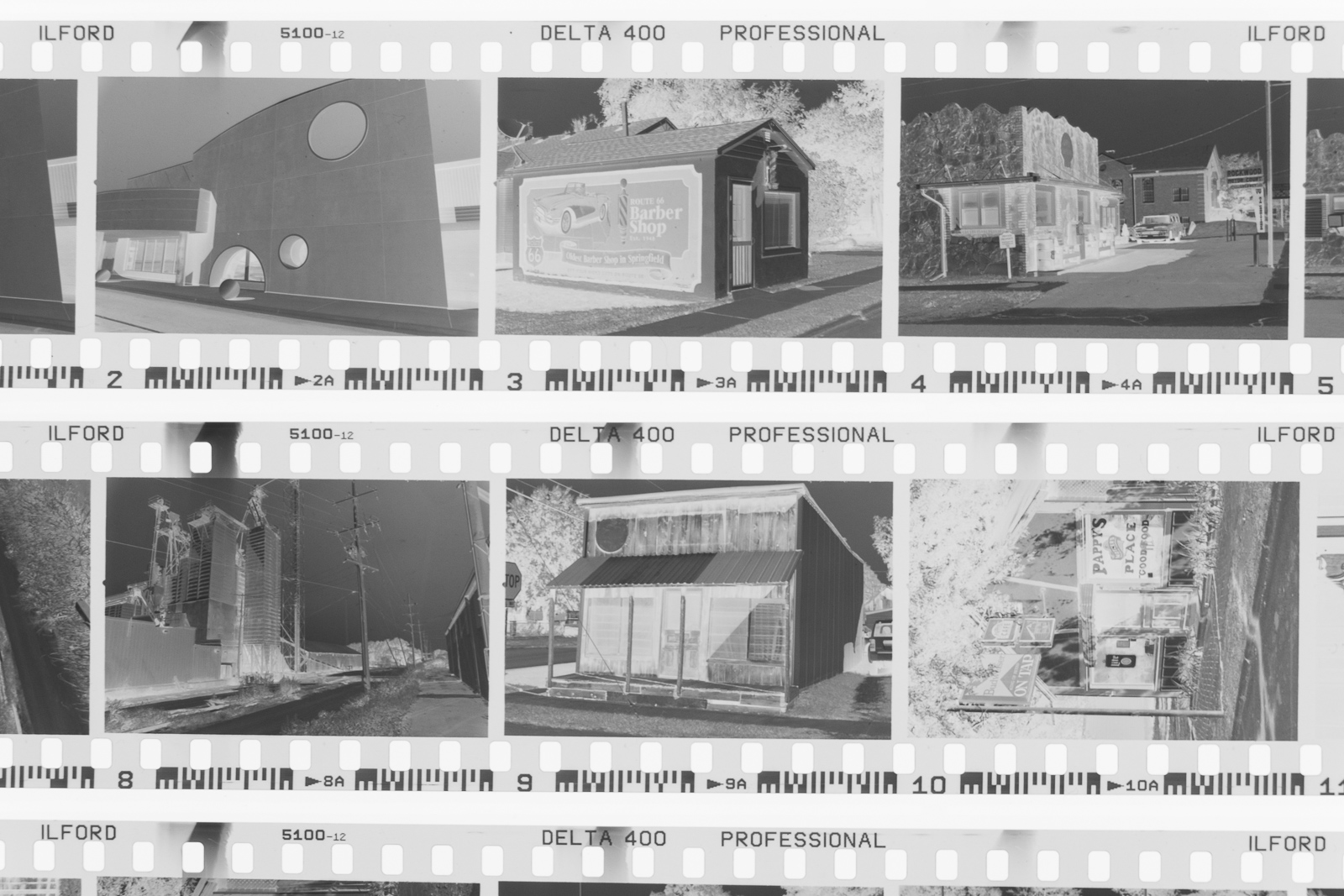

I had my Konica Autoreflex T4 professionally serviced: new seals, CLA, battery circuit updated, new leather. Yesterday, I developed the first roll after the camera was serviced, and it looks like I still have a light leak. I would like to try to fix this myself, but I am not sure what kind of material needs to be put where.
In a previous post <here> I learned the most likely location of the leak is near the bottom of the door hinge. Should I start with the foam which is parallel to the hinge? - or is it more likely to be that thin strip in the channel that runs along the bottom of the door opening? Or somewhere else?

Normally, you find the leak by inspecting the negative keeping in mind that the lens inverts and reverses the image onto the film.
Take some electrical tape and sequentially cover each edge or portion of the edge of the back - top right, top centre, top left, hinge side, bottom right, bottom centre, bottom left, latch side - and for each location take 3 or four frames, making sure that the camera is subject to intense light from different angles and directions for each frame.
When not taking photos, keep the camera from the light. This may be easiest if you work inside, and use flash tio both expose the film and illuminate the camera.
Be sure to note which pictures were taken for each position of the tape!
Develop the film, and see if you can pin down where the leak is coming from - it will be the tape location where there isn't any leak..

Examine the first and last negatives having the fogging, and see whether the horizontal position of the fog has shifted a little between the first/last frames. If the position has shifted, then film is being fogged while it's on the take-up spool. As the spool fills, the diameter of the film on it increases, shifting the fog position.
If there's a shift, the leak is probably at the hinge seal.
Otherwise, the leak is probably at the lower back seal.

At the first occurance in frame two, I measure about 7.3-7.4 mm from the left edge of the frame to the start of the light mark. Frame 34 shows the last clear example, measuring 9.0 mm. So the distance does increase, but not by a whole lot.
As mentioned in #8, I am shooting some frames with tape over the hinge and others with tape over the bottom edge of the door; I'll know more when I see those results. Meanwhile, I guess I need to track down a source of suitable sealing material for the hinge area.

In your first thread, folks suggested that the leak is at the lower hinge, and your measurements suggest they were correct.

I still have not found the source of this light leak.
Apparently, it is not as simple as leak the foam light seals around the door / hinge. The same marks at the sprocket holes appear, even after I have applied black electrical tape all the way around the door, and the viewfinder, too.

Put your camera on a table, back open, lens down. Place the negative on the rails aligned with the image window (proeprly reversed). The leak imprint on the negative will point to the location of the light leak. Three possible locations: across image window, offset one frame towards supply cartridge, offset one frame towards take-up spool.
