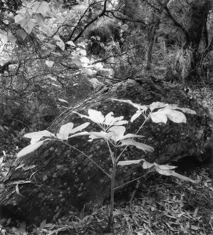

Gelatin-silver photograph on Agfa Classic MCC 111 VC FB, image size 21.4cm X 19.4cm, from a Konica IR750 negative
exposed in a Mamiya RB67 rollfilm single lens reflex camera fitted with a 50mm f4.5 lens and #25 red filter.
This one was shot with EI =1 on the light meter. The film went into Xtol-R developer with a mixed batch of other films for
11minutes 15seconds at 20C. Contrast was a pleasant "average" and the negative was easy to print on variable contrast paper
filtered for grade #3. I worry that POTA developers might deliver contrast too low for this film.
