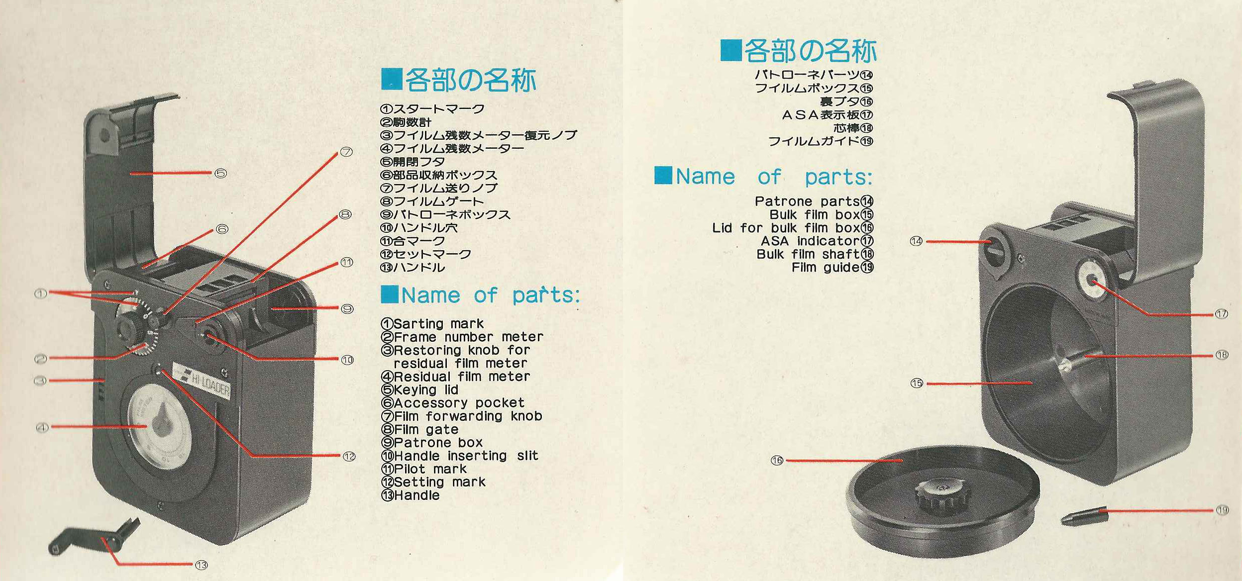

Hello, I purchased a bulk of darkroom equiptment and with it came a 'konica hi-loader' but there are no instructions and google search did not return much. I assume this is a device for bulk loading of film (?). There was also an empty packet of 30m film in this lot of equiptment. I have opened it and saw some film sticking out the end.
My equestion is, does anyone know how to operate this device and if so give me some instructions what to do.
Is there a way of finding out how much film is left inside?
Or is there somewhere I could find instructions to this device. I would not mind making a few rolls of film at home.
Thankyou.

I scanned this from the box of my cherry hi-loader, it should be same as your loader. Residual film meter (4 on the image) should show how much film is inside.
I like this loader very much, it wont waste too much film when loading casette and it's dead simple to use.
Hopefully this image helps! :smile:
This video shows how to use this loader.
[video=youtube;-eqnuilNnAM]https://www.youtube.com/watch?v=-eqnuilNnAM[/video]
For re-usable casettes, tape film to the spool that goes inside the casette and make sure it lines up with the film.

Hello, people. I have the original Instrutions for the KONICA HI-LOADER. See the file attached. (Forgive any error in my bad englise).
  • KONICA HI-LOADER - INSTRUCTIONS.pdf
