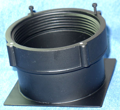

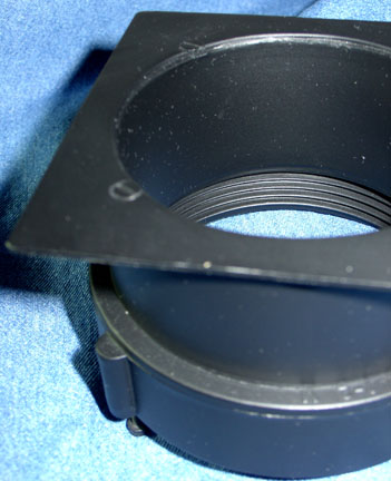

Adapter
Fitting this lens to a SG board may be quite challenging, but not impossible. Diameter of the lens is almost as big as the width of a lensboard. Therfore you will for sure need to connect it to the lensboard via some sort of an adapter. Since the rear lens will be larger than the opening in the board, some vignetting may be visible, but the effect of vignetting should not be significant at smaller apertures, I think. Some ideas you may get from attached photos. I used Home Depot plastic pipe fitting (fits Konica 300mm perfectly) to connect this lens to Wista lensboard. It required specialized tools like table drill, taps, adjustable circle cutter, etc. and some amount of time. I have just finished work on this adapter, did not put the lens on yet, so I can't tell how it performs.
SG vertical shutter is limited to 1/30, so in most cases you will have to use lens cover as a shutter (or similar technique).

Papageno, although Pacemaker Speed Graphics' lowest timed speed is 1/30, older Speeds go down to 1/10. Even so, your point is well-taken but I have doubts about its significance. My 210/9 GRII can be front mounted on a #1, so with it I have access to timed speeds down to 1 second. I rarely shoot it out-and-about at speeds slower than 1/30.
I must not have been clear. The approach you took is well-known. I have two TTH aerial camera lenses mounted that way by SKGrimes adapters on 2x3 Pacemaker Graphic boards. The big fat 12"/4's rear is larger than the board, so the adapter is stepped.

papageno, that is sweet. I've mounted a 10" Kodak Anastigmat and a 10" Kodak Copying Ektanon (both big barrel lenses) onto my 4x5 speed graphic.
Indeed, you need to mount the lens with retaining ring onto the front of the board. The ring is actually larger than the board, but there is enough clearance for the sliders on the front standard to hold the board in. Papageno's solution is better as you could probably a lot closer that way.
