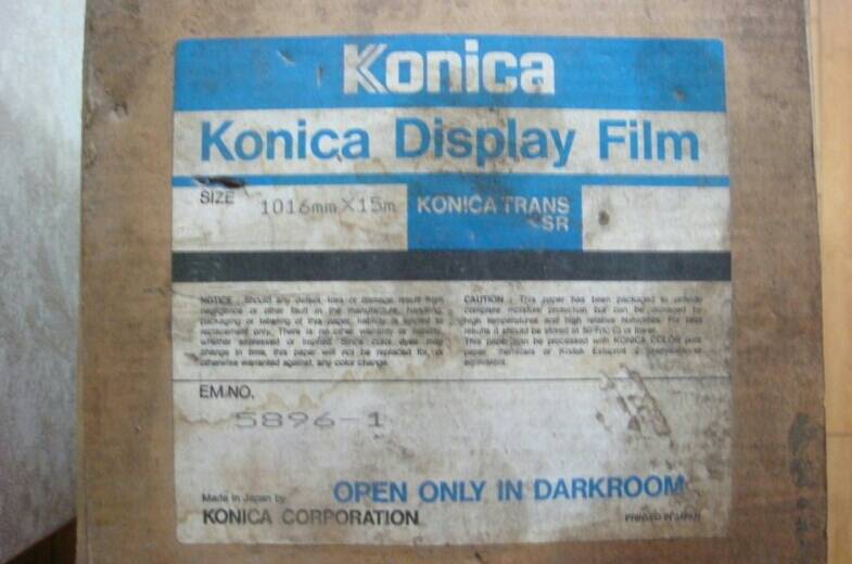

Any body knew such kind of film?
I got few information about it.
1. Triple thickness of normal film
2. E6 developing
3. ISO around 10

Display films are films that have emulsions quite similar to papers. They are made to yield positives on transparent film base or translucent white film base, to be mounted in lightboxes.
As they are not reflective they need to yield twice the density of papers. Typically they are negative materials (RA-4) but your material is to be reversal processed (E-6) to be exposed with slide film.

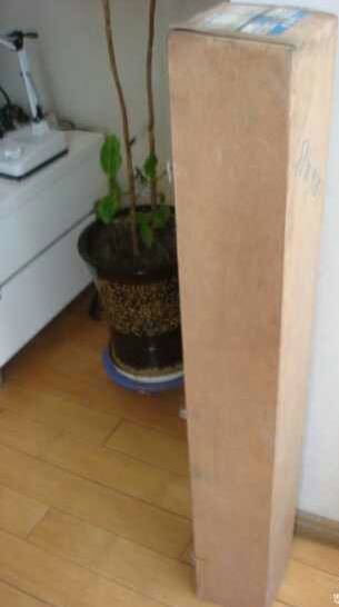

All the information above were from the seller.
Now he would cut some of it and send to me.
I will try to test it by E6 using jobo processor.

Unless it this extremely ancient (pre-RA4), all the display-films I can recall seeing were the same process as paper - RA4. They would be processed in the usual Kreonite type roller processor. Did anyone ever hear of an E6 roller processor over a meter wide??? Biggest would have been for aerial E4 and E6 films of 9 1/2" or so surely??
I'd suggest that it is most likely RA4 and should be processed as paper. The same RA4 process is used for the current digital-exposure printing machines, so the chemistry is relatively easy to find or beg for a test.
Given the age of the material you may have some 'different' results, with fog and colour-casts at least.
Could it be possible that the seller got confused somewhere, and the paper is a reversal material intended for printing from transparencies (ie. from E6 slides) ?? So far as I know, as the reversal-materials haven't been made for decades (completely different stuff to Ilfochrome), the reversal-paper type chemistry is no longer produced I think.

You can develop this material RA-4.
The material is similar to material from other manufacturers like ILFOclear, ILFOtrans, AGFAclear, AGFAtrans, Kodak Endura Clear, Kodak Endura Trans.

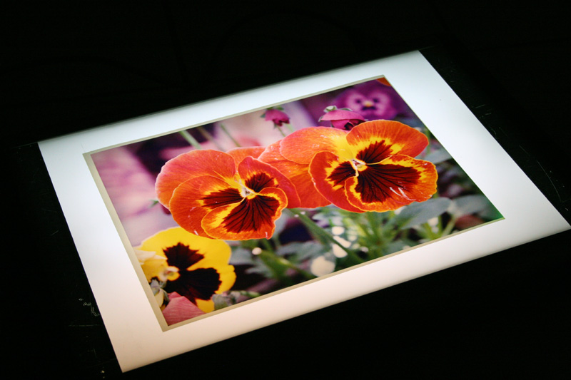

It is a nice material for doing large slides from negatives (see my picture of a 20x30cm print).
But it is a material for negative color process and so it is not good to be used as a camera film because of the necessary red filter.
One challenge is to find out the emulsion side in the darkness. The surface is very glossy on both sides. Wetting a finger and touching at an egde will show you the emulsion side (where the surface sticks on the finger a bit).
This material looks very old. It will probably have yellow/brown stain and may be fogged.
Note that you need about double the developing time in RA-4 because of the thickness of the emulsion.
