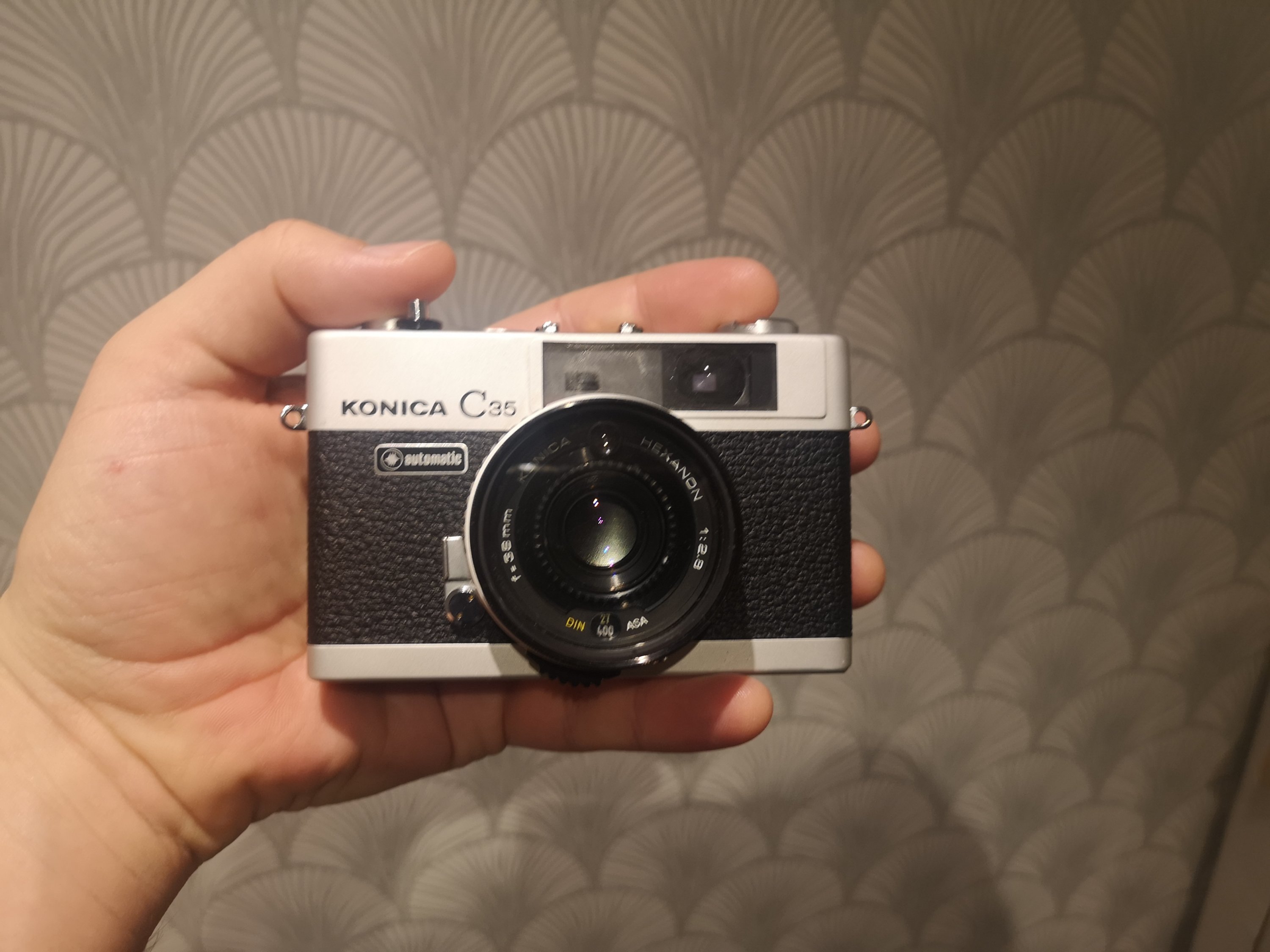

I have this really sweet little Konica C35 with a sticky shutter. The shutter opens when I fire it but closes slowly and sometimes doesn't close completely, until I release the shutter button. The B setting behaves inbthe same way, it doesn't stay open.
Any tios onbhow to fix it myself? It was a $16 camera...
The below video isn't mine but it's the exact same symptom.

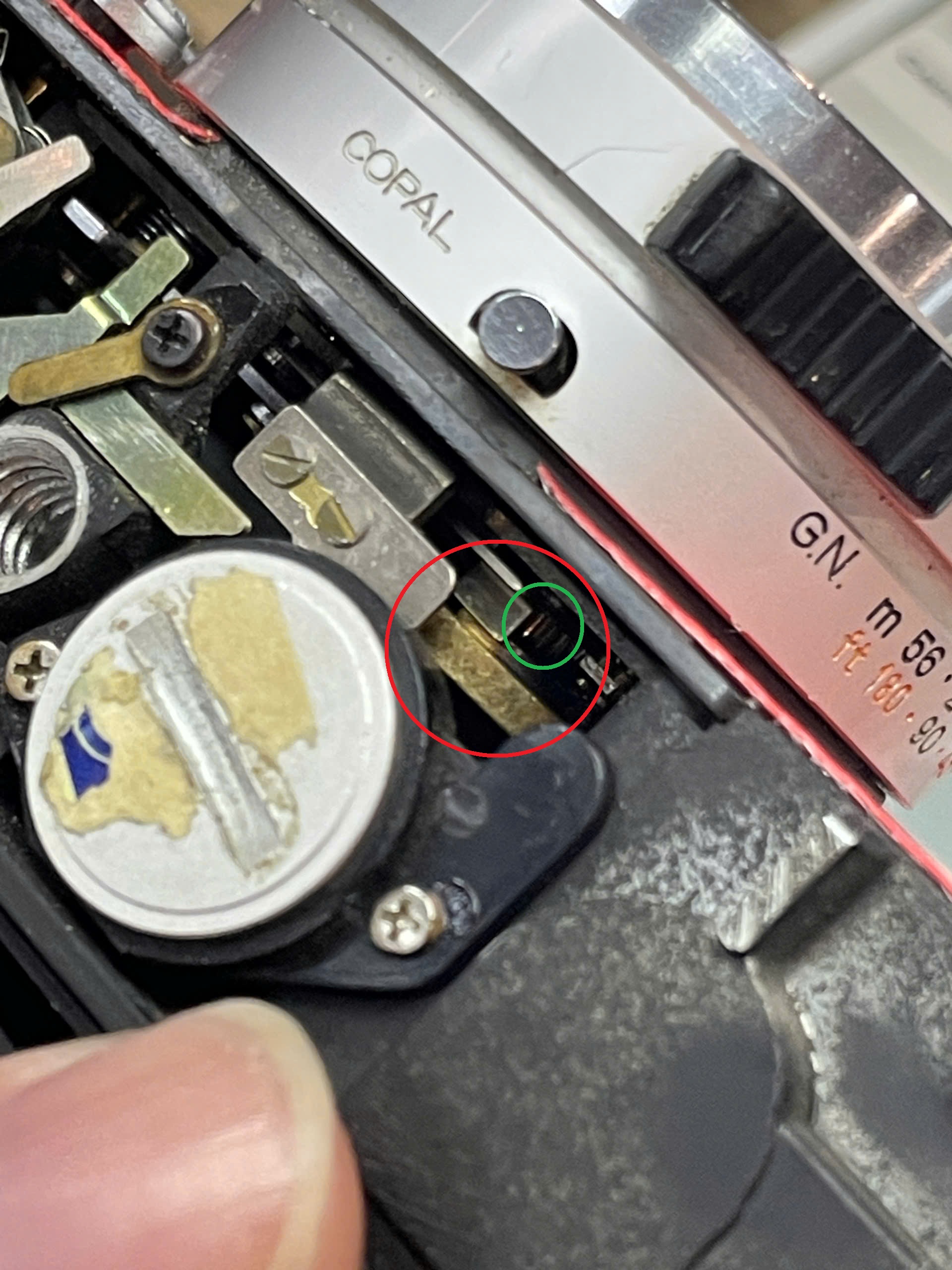

Just wanted to post here confirming that this method worked on an original c35. As HooMe mentioned you can see the flywheel lag following a shutter press. What you are looking for is a smooth gold wheel directly under the lens. It is attached to a small silver cog, that is what you want to oil. I used two small drops of fishing reel oil from a syringe. In my particular case the shutter would not only lag closed as OP described but also failed to open fully. After the oil its back to perfect working order.
adi_h
Oct 11, 2024
Bosnia and Herzegovina
Is the small silver cog you're referring to deeper in the camera and kind of difficult to reach? I'm trying to fix my c35 automatic that has the same issue described here and I don't wanna mess anything up.
