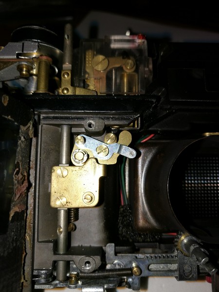

greetings. i'm having a problem (i think) with the shutter release on the kas2 body. if i hold the camera in a horizotal position (lens pointed at a subject in front of you), the shutter won't release. if i hold the camera in a vertical position (lens pointed to the sky), the mechanism will release. is this normal or is there an adjustment i need to make to the mechanism to get the shutter plunger to release completely? i'm trying to get the camera back together again is the lens housing (shutter and aperture blades) is now working properly. any help you can give in helping me understand the mechanism would be appreciated.

nuthin' huh. ok, well if someone could explain to me how the shutter mechanism on the body works in relation to lens housing levers and the auto aperture system, that may help. it appears that as the plunger moves down a lever on the lens housing tells the plunger "ok to fire" or not based on the meter reading(?)....although i thought the camera is available to work without the meter working, so maybe my hypothesis is wrong. any ideas?

for those of you encountering the same problem 5 years from now....
in testing, i found if i pressed the battery check button and held it (thereby moving the needle meter into the yellow zone) the shutter would fire. that led me to believe i needed to get the meter working and into the acceptable zone in order to get the camera to work. i found a loose wire at the battery housing, re-soldered it and got the meter working. working meter means the shutter will now fire. problem fixed, another kas2 up and operating!

You don't say what you had the aperture ring set to. The shutter will not fire if the aperture ring is on Auto and the meter needle is not in the yellow zone, either because the meter is not working or because of light conditions. If not on Auto, i.e., aperture set manually, the shutter will fire whether or not the meter is operating. Wondering if you were on Auto and got the shutter to fire when the battery check got the meter needle in the yellow zone.

i had it set both ways....on auto to get the lens housing on the body...no fire, which i figured would happen. then i set to 2.8 and various shutter speeds but still no fire. you would think it should fire, but it wouldn't. i could only get it to fire in manual mode if the meter was in the yellow zone. maybe there's still a problem with the camera. it does work now but only with meter operational.
