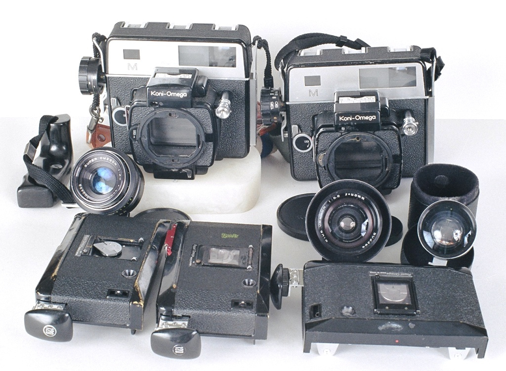

I liked the results I got from my Koni-Omegas, but the ergonomics didn't suit me.
Both of your alternatives are big, but they were both designed for (relatively) rapid use - the Koni-Omegas were popular with wedding photographers who had "downsized" from 4x5.
Here is a photo of the kit I sold a year or so ago. The shutter releases are on the front left of the bodies, and fall naturally under your left index finger when you use the grip.
And the "shotgun pump" sound when you advance the film is really impressive :smile:.
