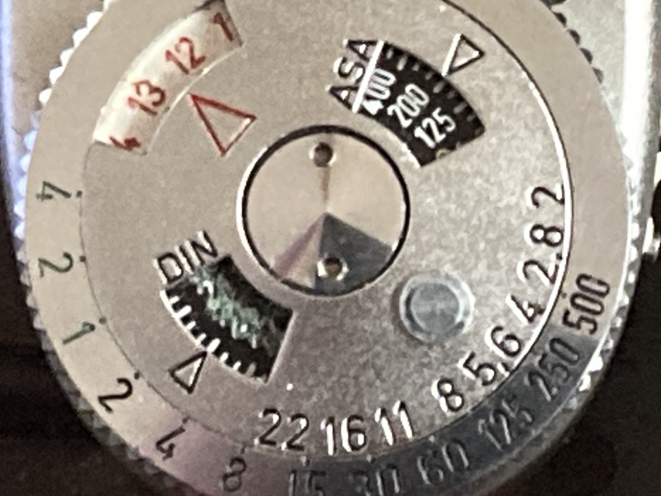

Hi all.
Just picked up this wonderful little meter and it's near perfect, except the ASA/DIN dial won't move, instead, it rotates the entire dial when attempting to set correctly.
The meter reads spot on when tested at the setting it is stuck at (200ASA) but I'd really like to get it working as I'm sure I'll forget in the heat of the moment to adjust the reading to match my chosen film's speed.
It seems to be "stuck" - any chance the application of a small amount of some WD40 (or equivalent) will get it moving smoothly again? Or do I need to take on some more intricate DIY methods instead?

To set the film-speed in your case you have to try to counter the twisting force by holding steady the shutter-speed dial.
In case that would not work you should instead of applying oil disassemble the dial apparatus, clean everything from maybe resinated grease or so and with a thin film of fresh grease at contact areas remount it all. Then wipe off any visible traces of grease film with a cotton bud.

Water Displacing #40 is not a good product to use on or in cameras or related photographic equipment. 90% Isopropyl Alcohol is a much better product to use.

Doesn't appear to be bent, but the DIN numbers are scraped - so something definitely isn't right with it.
https://retinarescue.com/files/smallkodaluxinstructions.pdf
Gossen Pilot rebadged/repackaged. A GE DW68 uses a similar dial/ASA setting mechanism. They can be stiff, were designed to hold the setting therefore not easy to move. It may be difficult to operate for those with large fingers.
When I try to rotate it, the whole dial rotates, but the actual ASA/DIN stays solidly in place, so I'm guessing it's "gummed up" somehow. It's almost mint (except for the dial and DIN wear), so I'm wondering if lack of use has something to do with it . . .
Those two holes in the center are for a spanner, should be a standard right hand thread, so unscrew the center attaching screw and see what's what. Oil or solvent won't help this one. Someone has had it open before so its likely not accembled correctly.
It is meant to stay. In such designs either the film-speed scale or the window is to be twisted. Not both.

The ASA dial should move the ASA range of the meter with the outer ring held steady. The ASA dial should rotate with the outer ring as it is turned when measuring light.
My guess is the ASA scale is in a bing from the center screw being installed incorrectly or someone locked it at a set position.

I meant you can't move the ASA/DIN window at all, instead, the entire dial rotates, but not that window: it's rock solid. Think someone else attempted to move it given the DIN damage, (but *not* by gentle means!), guess I'll find out when I get it apart why it refuses to move completely. :D

Thought I'd post an update, for anyone who is interested.
I managed to unscrew the centre and the ASA/DIN dial came off as did the small metal (?) o-ring that sat underneath. The "scratching" on the DIN section is actually a build-up of rust(?) - I can see the numbers through it but definitely won't budge.
Was fairly easy to put back together and I managed to marry-up the shutter speeds and f-stops correctly so that the readings matched my Sekonic, and the ASA/DIN actually moves at last! Unfortunately, there's still some slippage and the centre screw now starts to unscrew as I adjust the dials, even when I tighten, so obviously there is something amiss. Couldn't see a spring, so if there is supposed to be one present, it must be long gone.
I rather like the little meter, so I'll see if I can find a repairer here to check it out and put back together much better than I have. :D
