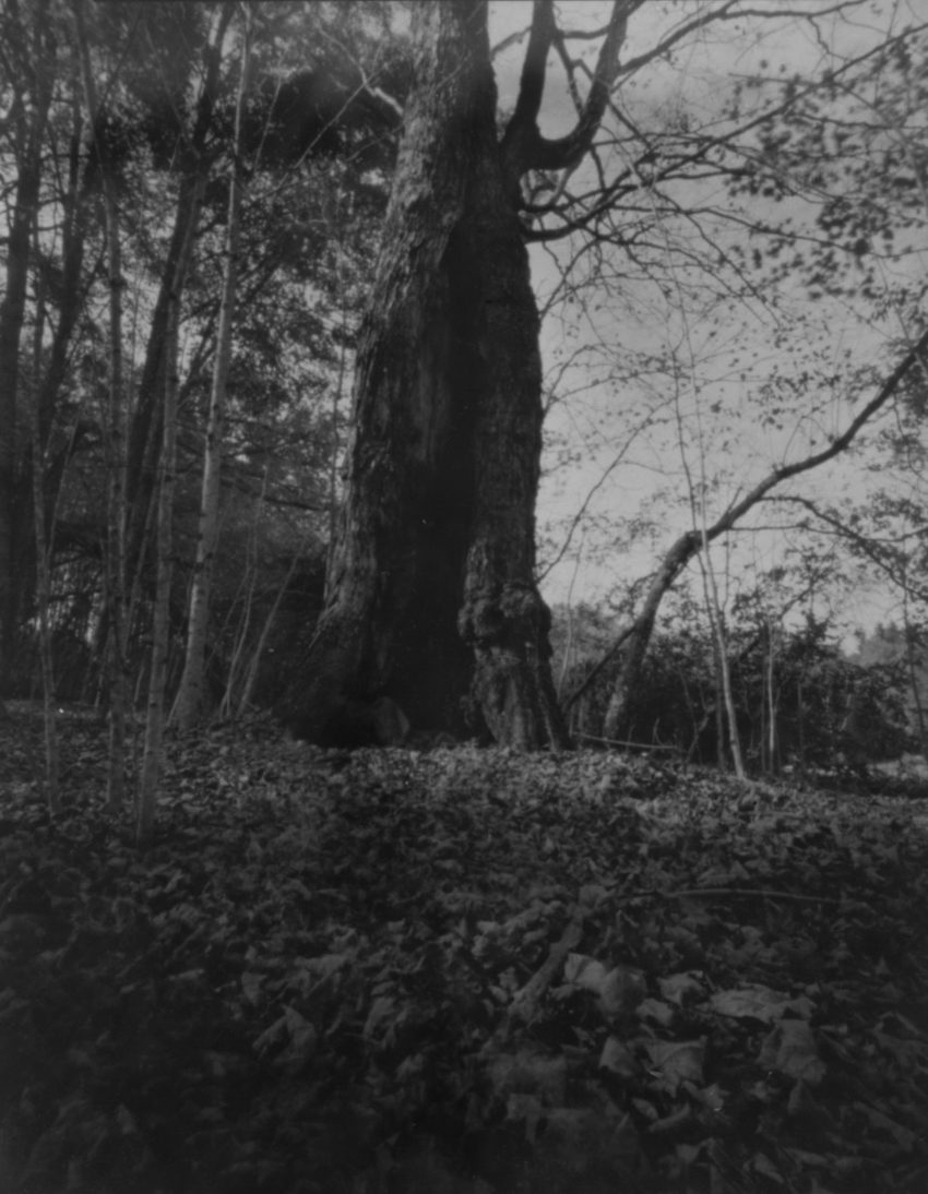

Tonight I developed two test shots I took with the Kodalith in my pinhole camera. I used Barry Thornton's Two Bath (the variant with Sodium Carbonate) and diluted each bath 1+2. It was something like 2.5 minutes in Bath A and 3.5 Minutes in Bath B. The results look promising. I made a contact print and it's in the wash now. I'll post a scan in the morning.
I transferred the film to water near the end and decided to put it back into the B Bath.
I didn't want to mix up what little Technidol I have for 2 shots and the 2 bath was nearing the end of it's life span.
So a while back I ran out of print developer when I was using the Harman Direct Positive Paper. I used the 2 bath to develop a few pinhole shots and it seemed to lower contrast so I wondered if it would work with the Kodalith. Here is the contact print from last night. I still plan to try what you all have suggested but I figured since the developer was near it's end I'd give it a try.
