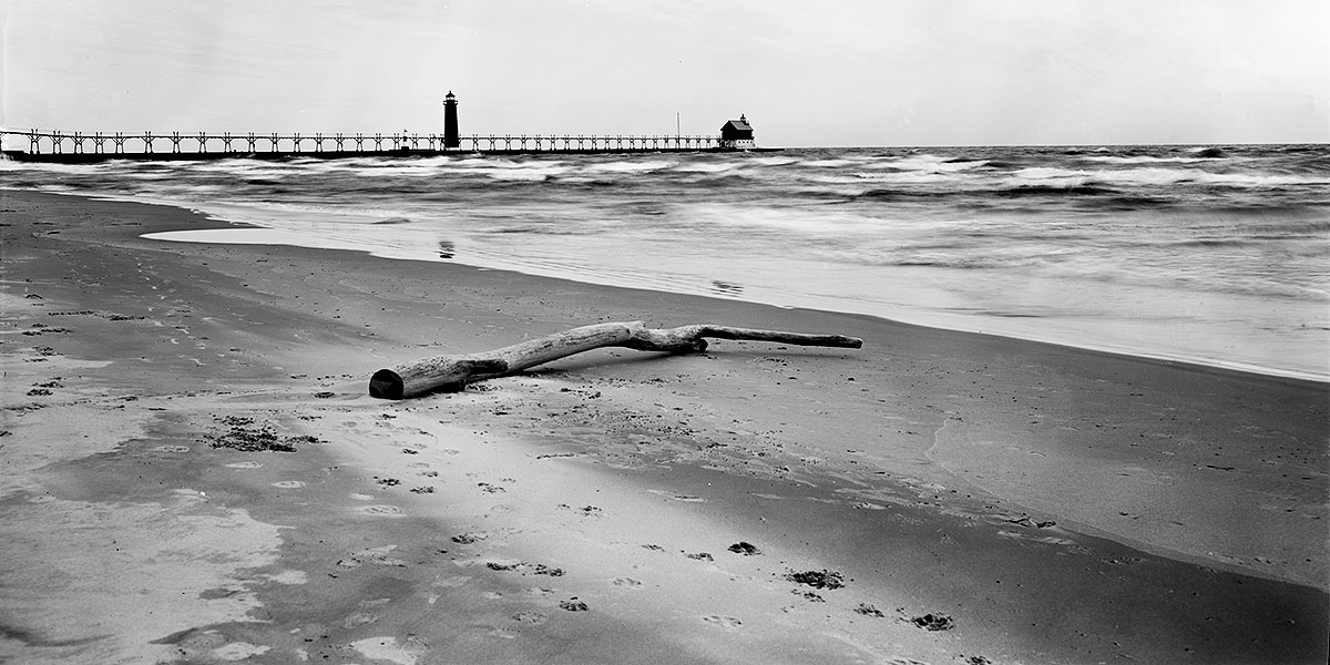

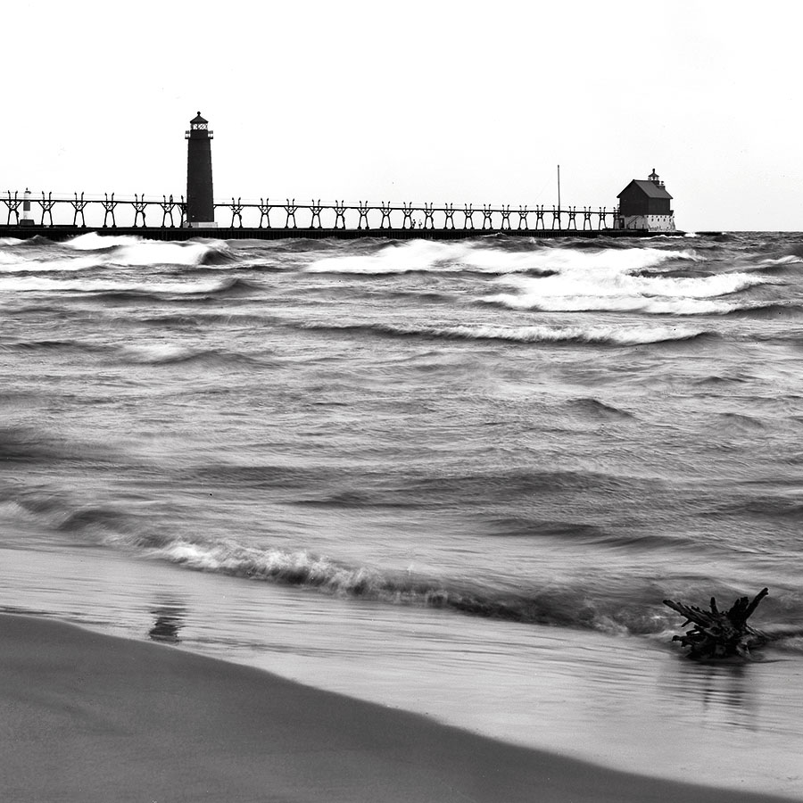

Hrm, I use this box of 4x5 kodalith ortho 2556 Type 3 film in my Crown Graphic 4x5. I've shot the following with it...
I'm basically using Dektol 1+3 at about room temperature (which can vary between 65F to 72F) and develop by inspection under a safe light until both the front and back side of the negative appears to be desirably dense. I also tend to rate my shooting of kodalith at ISO 12.

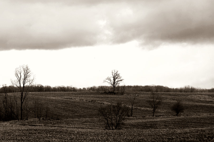

I shoot similar type of stuff on 35mm with Kodak UltraTec, which I shoot as ISO 6 (it hates being shot at 12), and develop in HC-110 around 1:120 dilution for about 3 or so minutes @ 68F/20C, which yeilded this shot.
Simply put, I am not shooting/developing the litho films anywhere near the way they were intended. But I really love the contrast of the stuff, and they both seem sharp as hell. It also gives me a much slower exposure time without the use of a higher aperture or ND filters.
