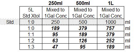

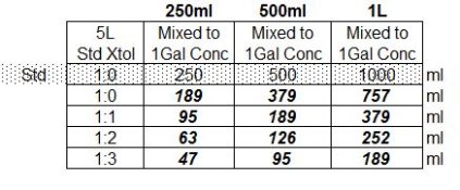

Here's what works for me... Mix in a 1 gallon thumb hole glass jug by gently rolling the capped bottle. The 5L chemistry will dissolve in the 1 gallon of water and this method will minimize aeration. I then save to my smaller bottles and use the attached grid for my dilutions.
It may even extend the life at this elevated concentration but I haven't checked or tested vs standard stock solution. I found a bottle over one year old that was forgotten and it gave me normal densities on my densitometer.
