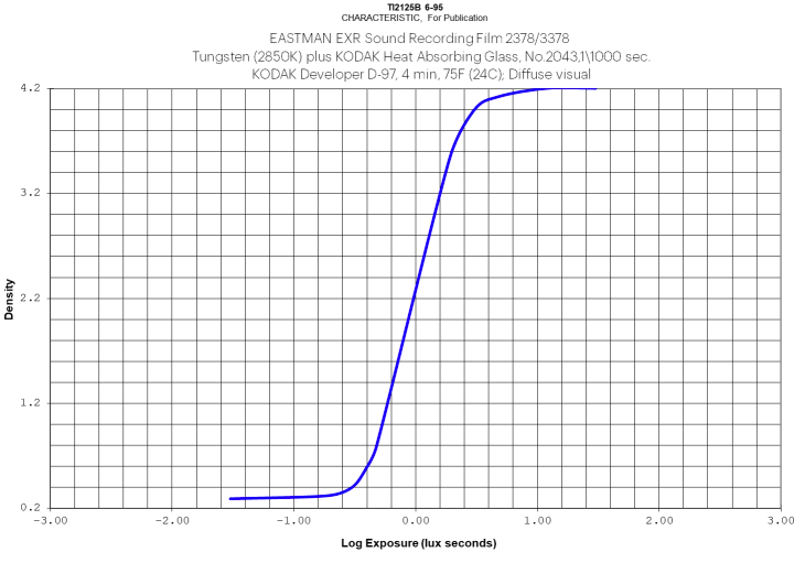

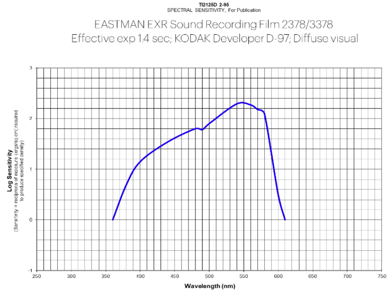

2378: https://www.kodak.com/content/produ...ing-Film-2378E-3378E-ESTAR-technical-data.pdf
So it's mostly orthochromatic with a little trailing sensitivity into red.
And it's enormously steep. It would be nice if you want to make line art or something like that. Also note the high dmax.

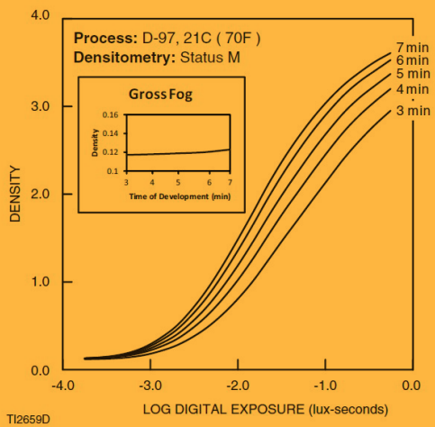

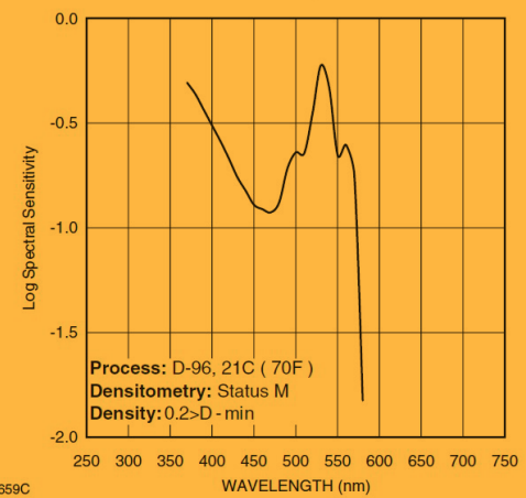

2237: https://www.kodak.com/content/produ...Digital-Separation-Film-2237-datasheet-EN.pdf
This one is orthochromatic with no red sensitivity, but also with a dip around blue, so it'll emphasize green.
Still steep though, so you'll need to 'pull' it to get somewhat normal B&W negatives.

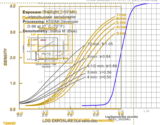

Here's the HD curves overlayed with 5222/DoubleX as a comparison:
Black = 5222
Yellow = 2237
Blue = 2378
