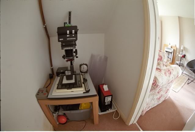

I wonder if there's enough of us colour printers in the UK to get together and cut down a roll or two. My darkroom is way too small to deal with rolls, but I'd gladly pay a premium to someone who can take on the task.

Yes, I think you're right, it will become the only way in the future. Sadly, my darkroom is 34" x 65" and is cramped enough without a big roll of paper and guillotine.
