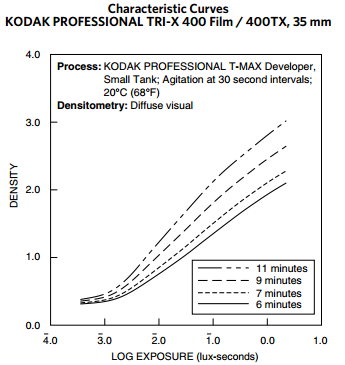

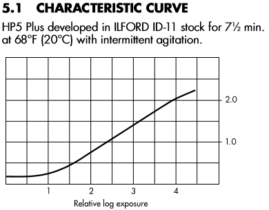

Anon Ymous
Feb 7, 2008
3,661
Greece
Aside from their box speeds, Tri-X and HP-5+ are not similar at all. Look at their curves and spectral responses.
Their spectral sensitivity is far more similar than you think it is. You see, Kodak's spectral sensitivity chart is an "equal energy" one, meaning that neutral light was used for the spectral sensitivity test. Ilford's on the other hand is made with 2850K Tungsten light, which has far more red light than blue light. Obviously, the red end of the chart would be boosted, while the blue end would be compressed, giving an impression of a fairly equal sensitivity across the spectrum. That's not true, it's quite more blue sensitive, just like most of the films.
Ilford used to publish better datasheets in the 90s, but strangely they decided to dumb them down. They used to include both an "equal energy" and a "2850K Tungsten light" chart. Bellow you can see the charts for both films, do you think they are very different?
The characteristic curve is to a large extent a matter of developer used and agitation scheme. Likewise, the older datasheet had a characteristic curve for HP5+ developed in ID11. If you compare it to Tri-X developed in D76, you'll notice that both are S shaped, a mild S shape actually.
