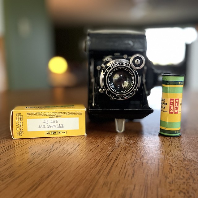

What do you think. How would you shoot this film?
All I have is Rodinal for a developer.
I’ve got maybe 4 rolls left.

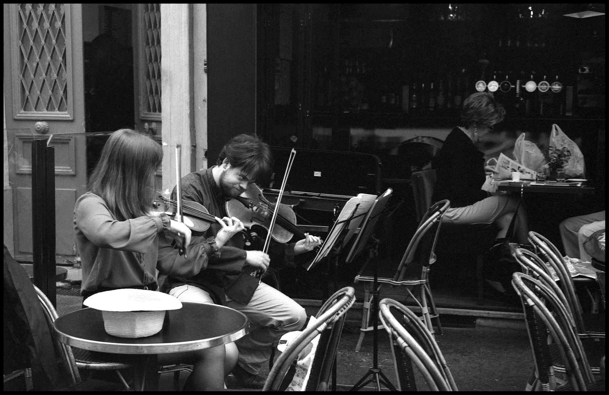

I've developed several rolls of 1986 SuperPan -- really like that film! Here are my development notes from 2014 -- note I rated the film at ISO 100. And I'm attaching a photo of this film developed as stated; scanned image (Paris XVII).
2 October 2014
Develop about 15 exposures of 20 yr old Agfa Superpan 200 at ISO100 w/ Leica IIIa w/ 5cm f/2 Topcor lens and metered with Polaris incident meter. Reflections in doorway, violinists, etc.
Develop in 200ml Ilford ID-11 1:1 with 200ml H2O Temp 70F. Pre-soak 2 minutes 70F water, some agitation; no color in water when poured out. Develop 14 minutes total, agitate every minute, usually with toss back and forth technique.
Water stop bath 2X
Fix for 5 minutes in chilled Kodak Tmax fixer (fourth use) at 70f, drain, water rinse and stand in water to remove coloration, then hypo clear (fourth use) 70F for 2-3 minutes, rinse several times and stand again in water.
PhotoFlo several minutes, hang.
Results: Base fog is visible. This combination of ID-11 with SuperPan appears preferable to 510-Pyro, which seemed reluctant to push up the higher values. I like how the Topcor images.
