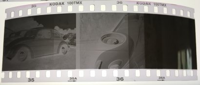

Hi guys,
I'm newly registered to the forum but the APUG has been a source of information ever since I started shooting MF film earlier this year.
After getting pretty good results with the MF, I purchased a 35mm rangefinder (Yashica Electro 35GX) and shot 2 rolls so far to test the camera: one TMAX400 which ended up being very nice and one TMAX100 which is causing me a headache...
The negatives ended up looking like this:
The space in between the frames isn't transparent as it would normally be, there are also lines through the images, sometimes faint sometimes more defined, almost like the excessive emulsion wasn't washed off properly.
So, now to the developing part, done manually in a Patterson tank:
Developer 500ml XTOL Stock: 5m 45s at 24 degrees Celsius (This is +15% since the 1liter of developer was used 7 times before - mixed in April this year and stored in an air free capped plastic bottle)
Stop bath 500ml: 30 seconds
Fixer Ilford Rapid Fixer 500ml: 5m at 24 degrees Celsius => This came out purple !
Wash with 23 - 25 degrees tap water: 2m
Final rinse with 2.5ml Kodak Photo Flo in 500ml Demineralised water: 1.5 to 2m => This came out purple !
I must admit that the developer has some sludge on the bottom of the bottle and although I shake the bottle before use every time, I don't check if all the sludge is gone, the whole solution gets a beige milky cast to it... This hasn't caused any issue before but if I messed up this might be important...
The oddities in the development process and the almost perfectly developed first roll shot with the camera makes me think I messed up during the development of this roll, but I cannot explain why the film is completely transparent near the edges of the strip while there appears to have been some exposure in between the frames.
I've checked the camera lens after this roll with a flashlight, the (leaf) shutter isn't letting any light pass through...
As you all can tell, I'm not an expert at this and I'm still learning.
Kind regards,
Davy

The development looks OK from what I can see. How many times has the fix been used? TMax/Delta type films need more time in the fix than conventional films. Your picture shows 2 frames that are separate, why not put them back in the fix for another 5 minutes, wash and see what you get? If the TMY400 was good and shot in the same camera then it is more likely to be the processing rather than the camera suddenly developing a fault. I do think you are being a bit mean with the re-use of the developer quite so much though. I use Xtol 1+1, one shot and throw away. It really isn't very expensive considering a pack makes 5 litres of stock. The wash of 2 minutes is too short: either use the Ilford water saving technique https://www.ilfordphoto.com/wp/wp-content/uploads/2017/03/Reducing-Wash-Water.pdf or wash for longer, at least 10 minutes.

The fixer is mixed a month ago and it was only used twice before I used it with this roll. As a side note: the purple color of the fixer was also gone after letting it stand until I finished hanging up the roll to dry and started putting the chemicals back in their bottles. I'm assuming it's still safe to reuse it?

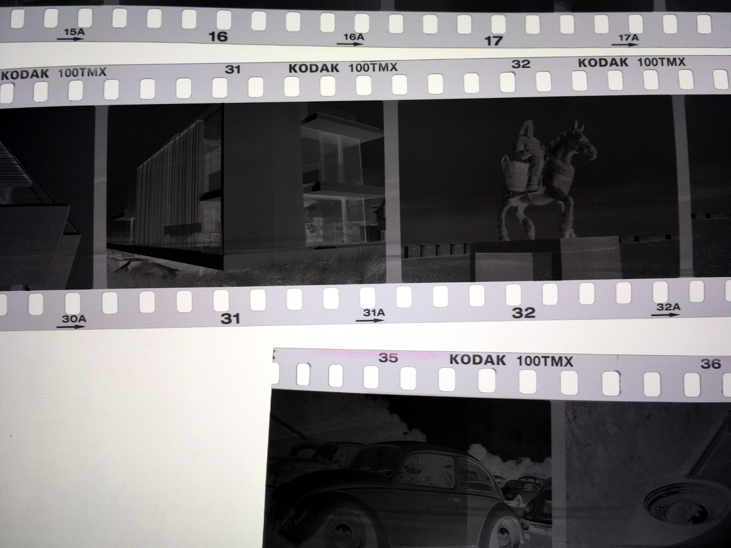

The 2 frames you talk about are the ones with the car on it? Since both the framing and the lighting is showing some issues I don't consider it a loss if I would mess up the negatives completely, so I guess I'll try to fix them some more this evening.

-) there is at least fogging at the spaces between frames
-) there are density lines going continuously over frames and spacers
-) one frame (car) has as straight vertical division between image densities
-) all artefacts are limited to the 24mm frame height
So there definitely is a camera issue.

Could the film have gone through the camera twice?
There look to be images behind the primary set......almost like the film went through at a higher ASA thus underexposing the first pass?

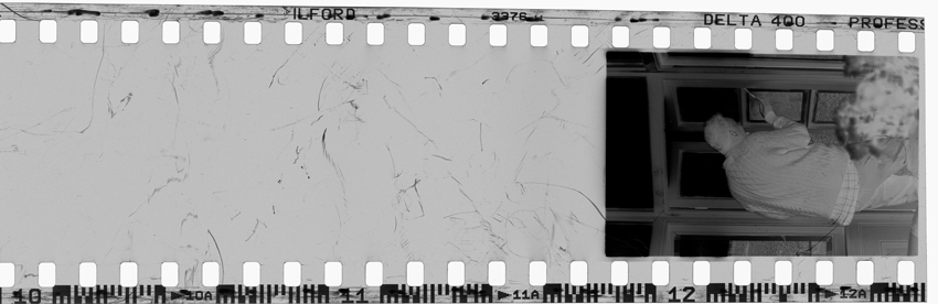

I just replaced the light seals in my Olympus OM4-Ti. It had a light leak but it didn't look anything like the OP's. The light leak in my camera affected the film edges as well. I wonder why this is confined to the frames? I'm thinking this is not the standard light leak through the traps that seal the camera back. It also seems very consistent. The gaps between the frames seem equally exposed. Maybe because it takes about the same time to wind each frame on but why would the leak not completely ruin some of the frames? Surely the light leak would be acting for longer on some of the frames than others unless it is something to do with the shutter.
Picture of the light leak I had. The frames are blank due to accidentally firing the shutter in my bag. This happened to 2 films in a row. No problems since replacing seals.

This is a problem with your camera. Because only the image-area is fogged (and not the edges), light is leaking somewhere between lens and film. Was the shutter partly cocked when you rewound the film? If so, the blades might have opened slightly, fogging film as you were rewinding.

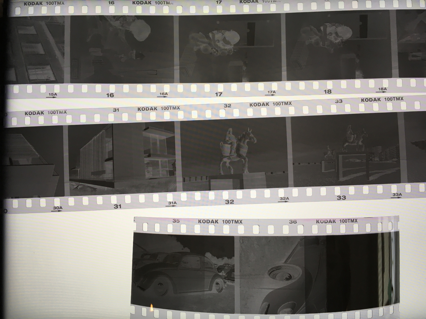

thanks for all the replies, I can conclude now that this isn't a development issue but rather a camera issue or even a specific camera state that has caused this...
I can share a more detailed image of the last two frames which (together with your comments) has led me to believe that the shutter blades didn't close properly after advancing the film after the last exposure and then of course, while rewinding the entire film, light caused fogging all over the 24mm film height.
Because of the last frame being so close to the end of the film, I think albada got it right in thinking the shutter was only partly cocked because I'm guessing it didn't allow me to turn the film advance lever as far as it needed to go...
So... this is actually a user error and not so much a development / camera issue? Is it a common error for cameras which cock the shutter together with advancing the film? Or is it Yashica specific?
I'll have to do some tests with a flash light to see for myself what actually what happens to learn from it to avoid this camera state.

I have repaired many leaf-shuttered cameras and their shutters, and can tell you a couple of things about them: (1) Most cameras will allow the advance-lever to back-up a little while in mid-stroke, and (2) many leaf shutters will open slightly if you back-up the advance at just the wrong point in the advance-stroke. These two facts suggest that your camera is fine and that you hit end-of-roll at the unlucky position. To avoid this problem upon hitting end-of-roll, I press the rewind-button, and while holding it in, advance the lever the remainder of the stroke, thus guaranteeing that the shutter is closed. It's okay to move the film-advance lever while holding in the rewind-button because the sprocket-advance is released, so you won't pull the film off the supply-spool.
