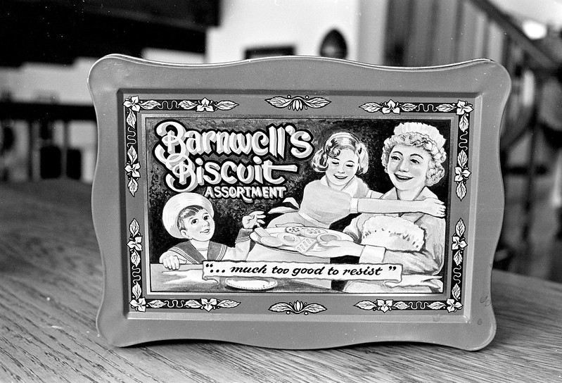

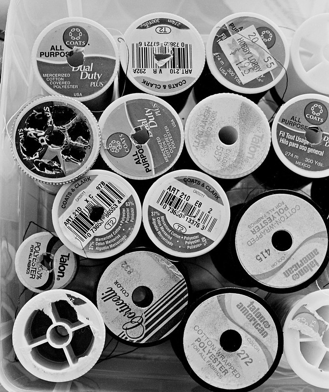

I think 510 Pyro works well with Technical Pan. It’s easy to make from scratch and has a shelf life of a couple of years. Here are a couple of examples using an expired 100 foot roll of 135 that was in a drawer at room temp for 15 years or so. Shot with a Canon F-1n, FDn 35mm f/2, ASA 25. Processed in 510 Pyro using semistand development of 20 min at 70F. Water for 2 min, then developer (1:300) with 30" inversion, then 15" inversion at 10 min, water stop and Ilford rapid fixer.
