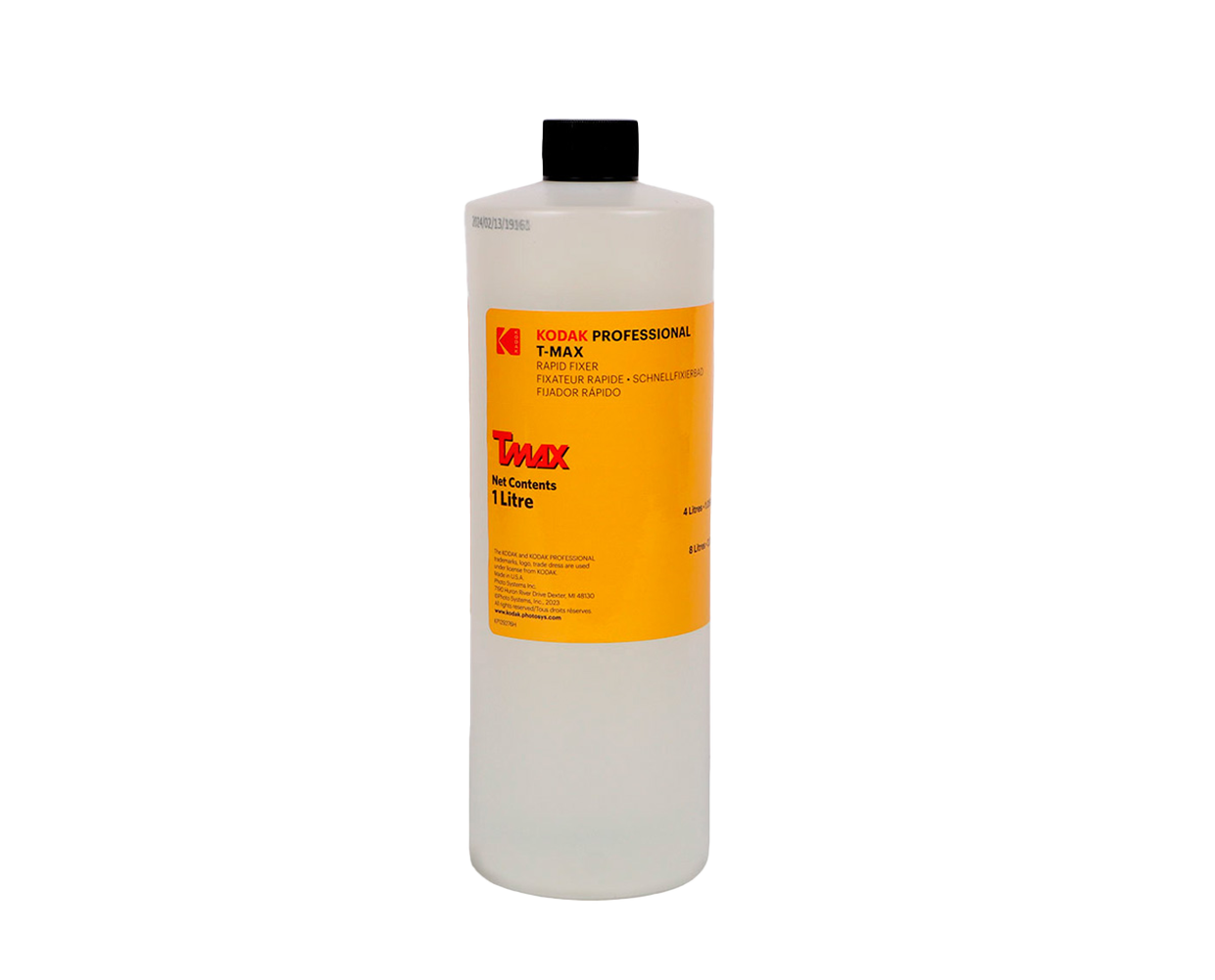

As I understand, Kodak is making two apparently different fixers for EU and USA markets.
The Kodafix for the USA market as seen here https://www.bhphotovideo.com/c/prod...ofessional_kodafix_1qt_solution.html/overview is to be diluited 1:3 (or 1+3) and contains an hardener.
The Kodak T-Max fixer as seen here https://rasetphoto.it/prodotto/kodak-t-max-rapid-fixer-1-lt/ makes 4 liters of diluited fixer total, so it's to be diluited 1+3 too, but I cannot manage to find a hint of the added hardener.
Anyone knows if the two fixers are the same, only differently bottled for different markets?
In other words: does the Kodak TMax fixer for the EU market contains an hardener too?

Sorry no, I've bought it yesterday and it says made in the usa by photo system inc
mfd date 2024/02
So it's fresh product of the latest run.
Here's better...

In that case it is the same product as the liquid Kodafix - just badged for the European market.

Photo System has answered my email. They say that the Kodak TMax rapid fixer does not contain any hardener.

The answer I received from Cinestill is that they reached out to the manufacturer, who responded as follows:
"TMax fixer is a European product which is similar to Rapid fix A, but different from Kodafix. Kodafix is a hardening fixer. TMax fixer is not. With modern films, hardener is not usually needed. Rapid fixer is better for T-grain films because there is less chance of a pinkish cast."
