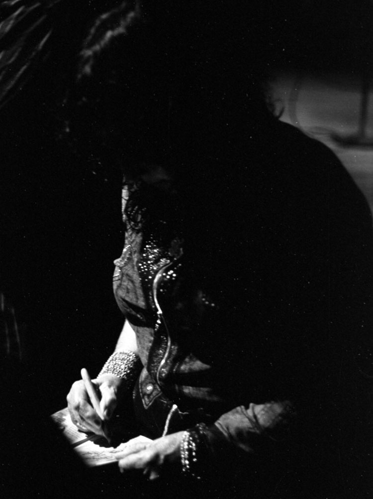

For 35mm I prefer to have my nature photography shot on fine grain film so I keep TMAX-100 handy. For 4x5 the additional sharpness of TMAX-400 gives me just what I want so that is all I use. For 35mm, I feel my prints lose out on some of the detail I like when I shoot TMAX-400. The gamble I have to take is, what kind of light and will I have a tripod. My worst nightmare was having TMAX-100 in the camera when shooting Maria Muldaur on stage at an intimate venue where there wasn't enough light for that film and getting called out for it. Now in my dreams I still see the glaring scowl and hear the contemptuous "What are you doing?"

Who called you out and why?
TMAX is so smooth and clean
Maria, for taking photographs after they explained their philosophy behind why they don't want you to take pictures... so you can enjoy the moment. But the moment was her silver jewelry and dress, and it was a visual experience best recorded on film... hard to explain at the time.

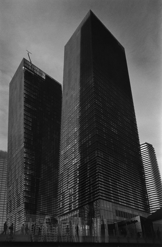

TMax 400 and 100 are two of my favorite films. They seem to have a bit more "modern" feel to me, a bit smoother than Tri-X and HP5. Whether you like TMax or not will probably depend on your preferred subject matter and how you process and print. I like to overexpose them about a stop. The negatives look dense, but I get good mid-tones and lots of shadow detail. I've never had any problem printing down the highlights, if needed.
This one's TMax 400, developed in D-76 1:1 and printed on Ilford MG paper. Leica M2 and 35/1.4 Nokton lens.
