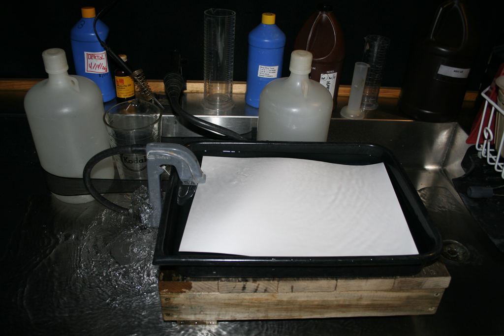

Here's my siphon set-up. The tray has to be kept above the outflow, so I built a small wooden table for the purpose.

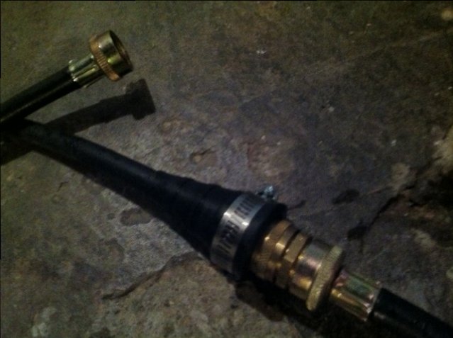

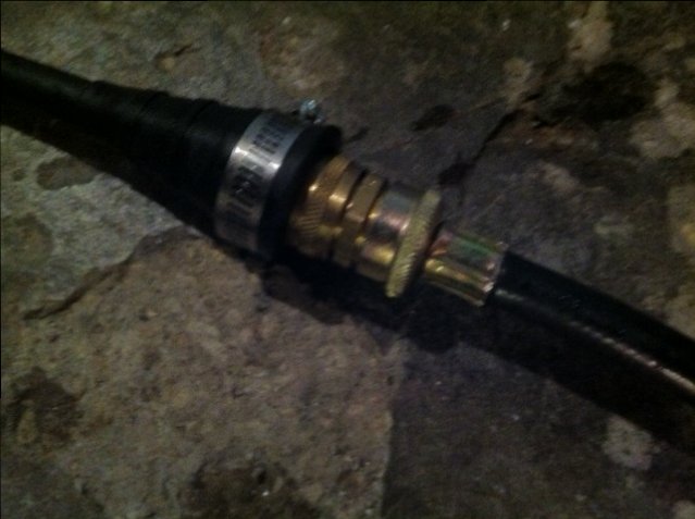

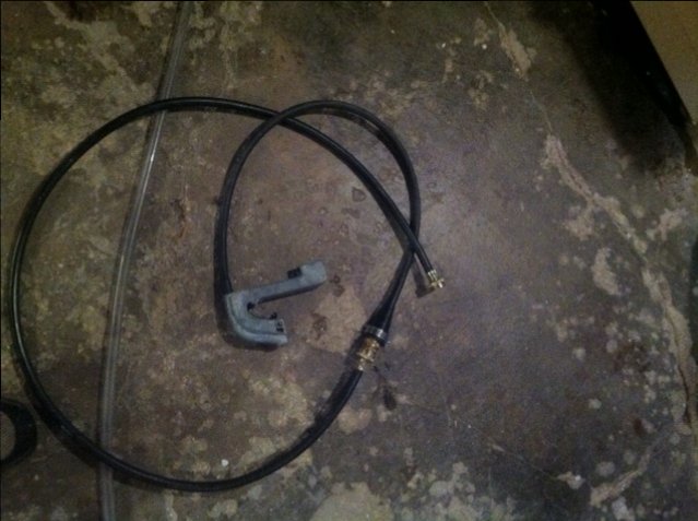

Thought I would share what I eventually came up with. Forgive the convenient iPhone photos. Used a bag of brass plumbing fittings I got at a garage sale for 50 cents.
