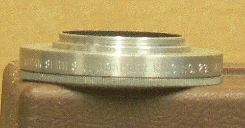

I have a Retina IIIc and a Retina IIc. I just received a Kodak Series 6 adapter ring (31.5mm/1.25"). It slips on the lenses of my Retinas closely but does not snug up. Sothe adapter ring falls off the lens. Is it common to get the pliers and slightly bend a few of the ring prongs so that the ring will secure itself on the camera lenses? OR did I buy the wrong size? Thanks.
Sirius Glass
Jan 18, 2007
50,364
Southern California
The prongs need to be carefully squeezed in. Do a little at a time until if grips but not too tightly.
Paul Howell
Dec 23, 2004
9,686
Scottsdale Az
I do this all time to fit a number of lens, yesterday I had to work on a SVI to fit a Kodak Tourist.
BrianShaw
Nov 30, 2005
16,530
La-la-land
I use needle nose pliers. But very gentle movements to (1) avoid over correcting and (2) breaking the flange sections. If you can find them, the original instructions actually discuss this and suggest that .5mm, plus or minus, is acceptable. In practice, the amount of adjustment might be a bit more.
