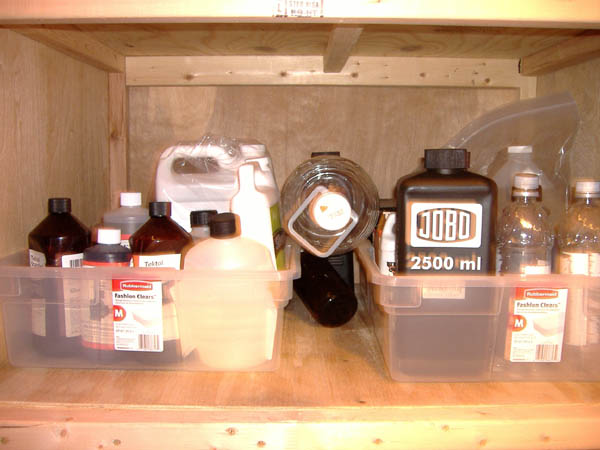

Dear tkamiya,
I store my liquid chemicals in low sided plastic tubs. Still easy to get to but would contain the liquid from a failed container. A little belt and suspenders just might save a cleanup issue in the future.
Neal Wydra

Neal,
Yes, I do that too. I keep all of my liquid concentrates and stock/working solutions in deep plastic tubs with lid. On my processing table (wet side), I have a giant shallow plastic tub and trays are inside it. As my DR is a converted spare bedroom, it is carpetted. I really don't want to spill anything or I'll have to rip up the carpet.
