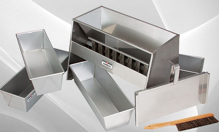

You use a riffle splitter to do a proper job of dividing powders, made in many sizes. Powders need to be free flowing. In previous life I used a lot of these.
